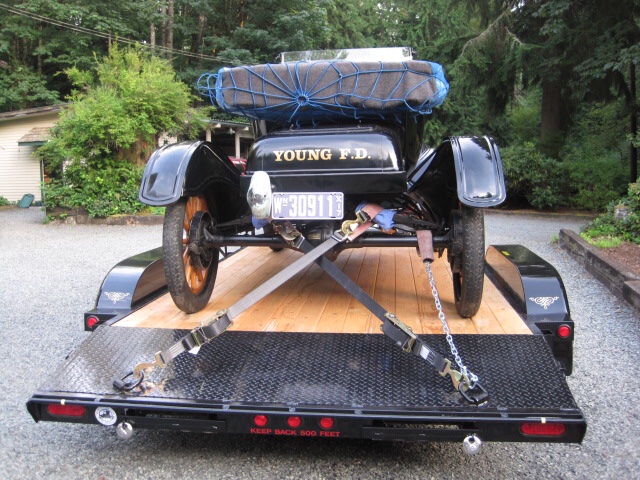

Congratulations on your purchase. Use the springs and be sure to cross the straps. Jim Patrick.

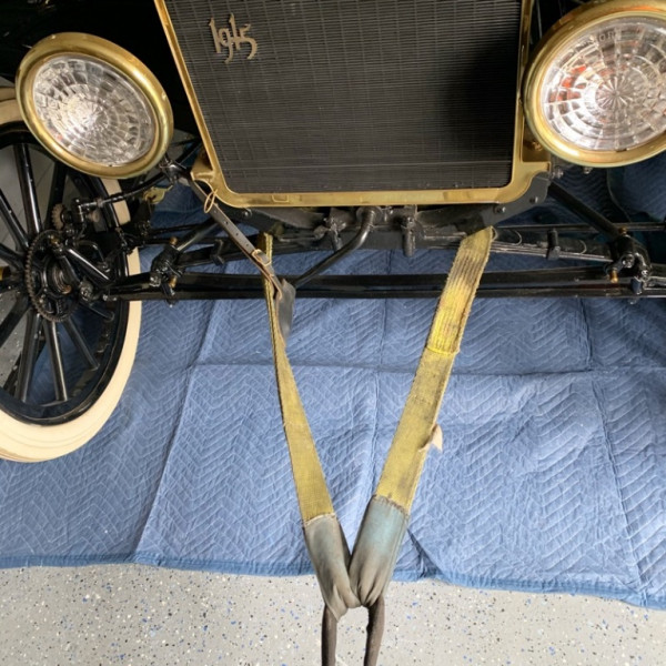

With a 1913 T and the early type above axle front wishbone I would NOT Tie to the front axle. Tie around the spring up by the frame and cross the straps. Same goes for the rear, tie around the spring up by the frame and cross the straps as shown in a prior posted rear picture.

The 1913 has no radiator apron so you can feed a short strap (such as a two-foot strap with metal loops at both ends) through the gap between the radiator and the front cross member, wrap the short strap around the front frame cross member. Tie your front straps to the metal ends of the short strap, this will get your straps tied to the frame, the most secure member for such purposes.The front axle is tied to the T only by the wishbone ball and socket joint, far too weak a connection to handle the torque generated by a lurching automobile. Even wheel baskets or nets on the front are still reliant on the ball and socket joint of the wishbone, not good enough.
In the rear there is less of a problem. The rear wishbone connections are much stronger, were designed to handle rear-thrust torque. It is possible to wrap the tie-downs around the top of the springs, up closest to the rear frame member. Cross the tie downs left to right, right left, to handle side to side sway, and all should be well.
Just to be sure, set the parking brake, and place wheel chocks in front of the front wheels and behind the rear wheels, assuming you drove the car into the trailer front end first.
The above method gets your car secure without having to take hours to secure it in place with numerous straps to handle multi-directional torque.

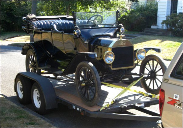

Post pics of your "new" car!! I love my '13, you'll love yours too. Something about
this particular model just captivates.

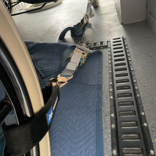

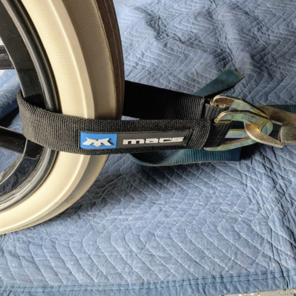

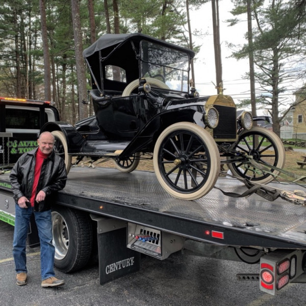

Transporting a Model T
I just loaded this 1915 Model T Runabout up
in Bolton, Massachusetts.
Going from one family member to another
This trip will be unique
I have to pick up another Model T in
Michigan that is also going from one family
member to another.
Since 2006 - I have personally transported over
(400) Model T’s of just about every body style
and configuration.
A few years ago - I standardized tie down
Methods for all Model T’s & Early Brass Cars.
If the wheels - spindles - bearings are secure
and in good order:
Mac’s axle straps thru the wheels
Ratcheting nylon straps from the wheel
Back to the center of the vehicle in line
This holds the car together
This helps keep the car from “ walking “
Across the trailer floor
I have etrac installed about every four feet
Width wise across my trailer
FJ

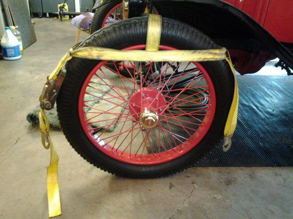

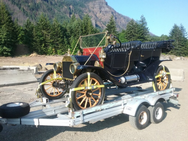

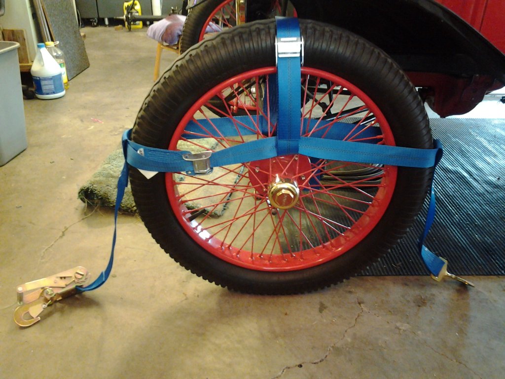

Wheel nets are the best option - let the original suspension operate - our country's roads are atrocious !

I'm not referring to "U-Haul" wheel nets - I'm talking about Mac's & my custom made for 30 x 3.5 tires wheel nets. I've got thousands of miles towing with wheel nets - never had one loosen or remove itself - one needs to frequently check your lashings though !
BE_ZERO_BE
- Posts: 662
- First Name: BOB
- Last Name: CASCISA
- Location: POULSBO, WA
Re: Transporting a Model T

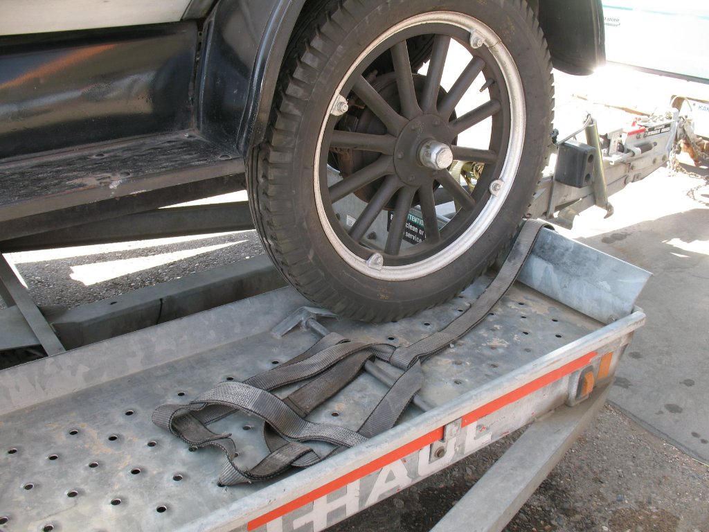

I had modern tire wheel nets when I first got my trailer.
I quickly replaced them with some off-the-shelf fully adjustable wheel nets.
The horizontal loop is adjustable and can reach around a T tire easily.
The top over strap is adjustable as well to keep everything snug.
I always check my tiedowns at every fuel stop.
OLD WHEEL NETS ADJUSTABLE WHEEL NETS

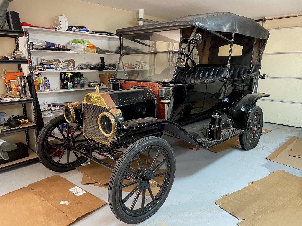

That is a VERY nice looking car with everything patinated similarly. I personally would need to see some very bad things going on with the top, to condemn it. Same thing with the tires.
This is my opinion and not a pro or con opinion regarding the propriety of restoration, refurbishment or refreshment: you just bought the car and are entering into an entirely new world...lots of things to learn, do, consider...once you make the (perhaps necessary) decision to put on a new top, you are going to be creating a vehicle with dramatic and obvious disparities in age and condition...this will all most invariably lead to the need for more refurbishment which will lead to more disparities. Your car, your choice...just predicting the future as it might play out and if that's your plan and have the time or money, go at it with gusto. If that's not your plan, give the disparity angle some thought.
I have 4 T's and my 1913 looks just like yours, with a very old water-stained top that looks just right with the rest of the car. Now, what I will recount is My experience is with my '15...it was bought in the late '60's from the original owner, by a young guy looking farrrrrrrr into the future to have a retirement project. At some point, he replaced the original seats with a really poorly executed interior. Later, the top was done and it is gorgeous and a quarter bounced on it would hit the ceiling...a Marine DI would approve. Fast forward to a few years ago, and his now-advanced age and health called a halt to any further debasement of a car that could have previously vied for the "Rip VanWinkle" car. And you know what? The rest of the car looks exactly like about 1919, with perfect original paint, wheels, brass...the seats look poor, the top is a prize winner, and neither look correct at all on the car...every aspect of the car begs for "restoration", which it will not get...I'd even wager that baring a rock-slide having gone through your top, it would look just great (and more fitting for the condition) on my car.
