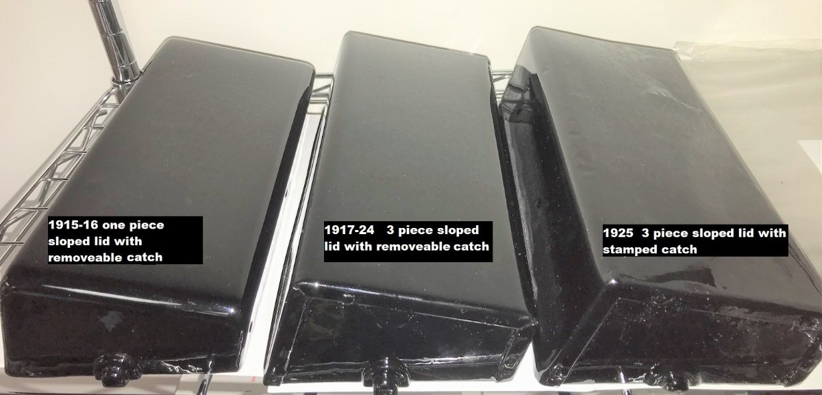

The lids are the same from about 1917 to 1925. There is a lip inside that presses the coils down. So yes a lid will keep the coils seated.

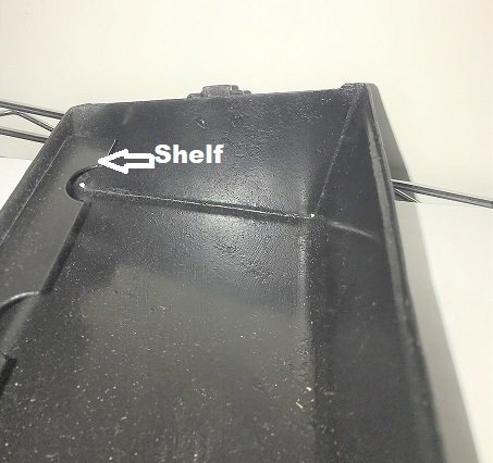

Caution on some of the reproduction slant top lids that have the sides and internal shelf spot welded which caused t he sides to warp. The shelf on the underside of the lid is what keeps the coils in place.

I thought the 15-16 lids were used into early 17 too.

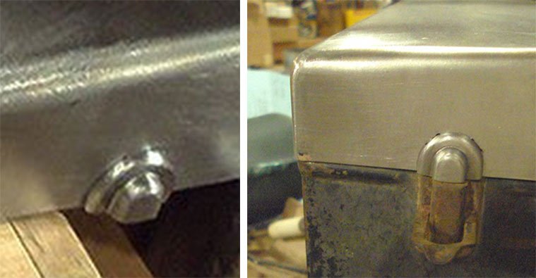

TRDxB2. what are the hinges mentioned in the descriptions of the lids? I don't believe I've ever seen a coil box lid w/a hinge.
Re: Coil Box Lid
Post by Rich Eagle » Sun Apr 18, 2021 11:37 am
I suspect the description refers to the latch piece. The catch that mounts on the box itself sort of hinges to catch it.
Sorry for the confusion. I corrected the image with the proper term see above
Like most all parts transitioning from one year to the next - use up the old inventory. I also read that the date a part was manufactured doesn't always align with when it was available on the assembly line.

My late 14/early 15 wide track has a 13 rear end. Being so uncommon & last in first out inventory, its not unreasonable to believe it came that way from the factory.
