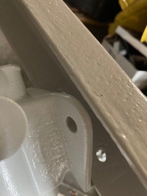

So I notice that my early steering bracket does not align with a 26-27 frame holes. Will a 26-27 Steering Bracket 3539DU work for a early steering column?
- Posts: 4084
Re: Will a 26-27 Steering Bracket work for a early steering column?
Yes, depends on your speedster dash/ firewall position. Most speedsters drop the column for best seating as the gas tank normally is relocated so seat in lowered too.
So most add wedge under the bracket to tilt the column down. Re drilling holes in the frame can be done too.

Here is the steering column support bracket on my 1926 coupe. I suppose if the hole pattern matched up, it would fit. Jim Patrick
