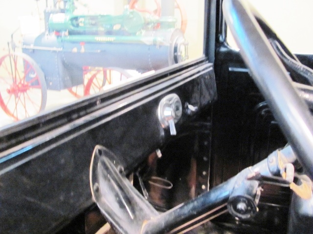

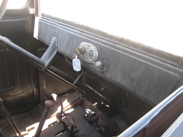

I'm confused! Most TT's in 26 & 27 still use the earlier style dash panels, but I have seen closed cabs with the passenger style. What is it?
Posts: 5592
Re: Another ammeter question
Post by RajoRacer » Tue Apr 20, 2021 12:27 pm
Larry - I've not seen any open cab TT's with the "Improved" passenger car style switch plate but I have seen later closed cab TT's with the passenger car type and the dash has the oval cut-out rather than the square one as most '19 to '25's passenger cars sport.
Posts: 4084
Post by DanTreace » Tue Apr 20, 2021 12:46 pm
Here's two different closed model TT's, late models, with the Improved Car oval switch plate. Ford did these ;)
If the ammeter in question is a new reproduction small '26-'27 type, these are Model A meters, with special 20-20 faceplates, and the Model A is positive ground, so you have to switch the wires at the terminal posts on the rear of the meter, for Model T negative ground. They just don't make both anymore.

I have a "depot hack style" lnstrument mount with the 26-7 style cutout. Is that what you mean? Its stamped steel, a little bigger than the switch assembly . I think they were on TT's, not the style full dash as pictured.
Posts: 5545
Last Name: Gregush
Location: Portland Or
Post by Mark Gregush » Tue Apr 20, 2021 2:04 pm
They are talking about the small panel that the light/ignition and amp meter mount to, not the bent bracket that it attaches to in your case. This would be the 1919 to 1925 car style and sometime in to 1926 TT style; http://www.mtfca.com/discus/messages/41 ... 1414604498
Post by Rod Petrie » Wed Apr 21, 2021 8:44 am
My switch plate is like the second picture and i have a repro ammeter. If the ammeter is Model A this explains the need to reverse the wires. I did reverse the wires and it now reads correctly. Thanks for the help.
