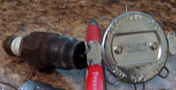

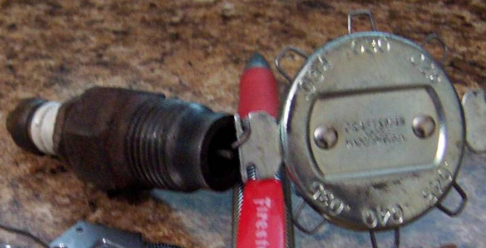

PS. Also, I am adjusting the gap to .025. Where, on the center electrode, should the angled side electrode be positioned? Should the entire face of the angled side electrode be positioned next to the center electrode or a little above? I have the new style on the right.

I am no expert, but my grandpa taught me to make sure the side angled electrode runs "uphill"and on the side. That way any oil that collects on the electrodes will not run to the gap but away from the gap.

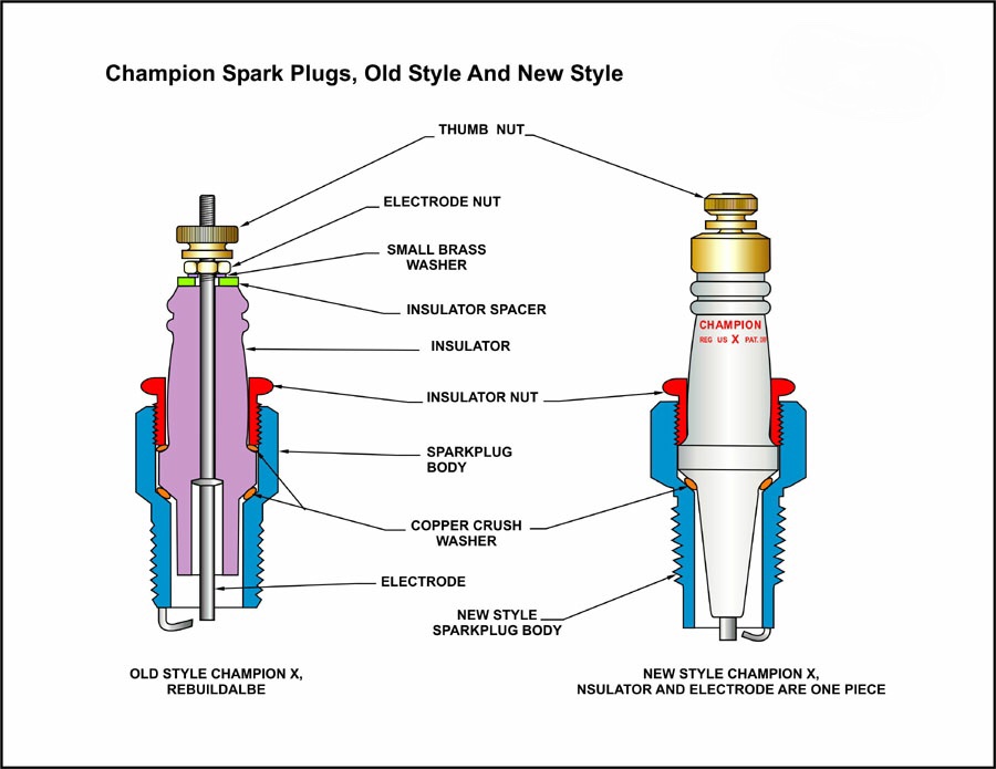

The spark plug needs to be grounded to the head (Teflon tape may insulate) . Many discussions suggest using aluminum foil if its necessary to improve thread seal. First gap per manufacturers instructions - then if necessary to what others do to their unique motor. The X plugs gap to the side not the end of the center post.
The picture is from a previous discussion. The red tool is just to hold in position for t he photo. Most important the proper tool is being used to adjust the gap and it has the proper style wire to measure the gap.

What Donnie said. On both old and new style Champion X plugs the side electrode (cathode) angles up toward the side of the anode (center electrode). Incidentally, this makes them the easiest plugs to test.
