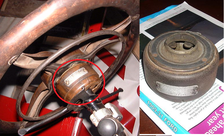

Anyone have a Seng Steering Wheel that could let me know how to get the horn ring working? I'm pretty sure I have a missing part that is right below the wheel that contacts the horn ring.. There has to be a sliding part that contacts the ring on the wheel.

Yes I saw that link. The part I must be missing is below the wheel, seen in the first picture and the fifth picture. I looks as though that part is covering the steering gear case. I am asking if that part somehow is able to go around the gear case. I wouldn't think a steering wheel manufacturer would supply a whole new steering case.

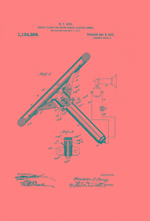

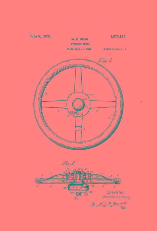

Re: Seng Steering Wheel
Post by John E. Guitar » Tue Apr 20, 2021 10:15 pm

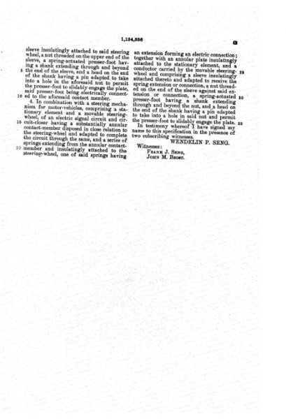

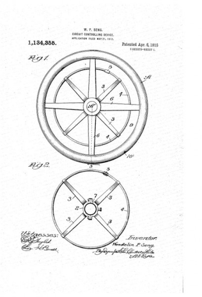

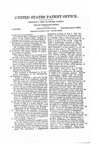

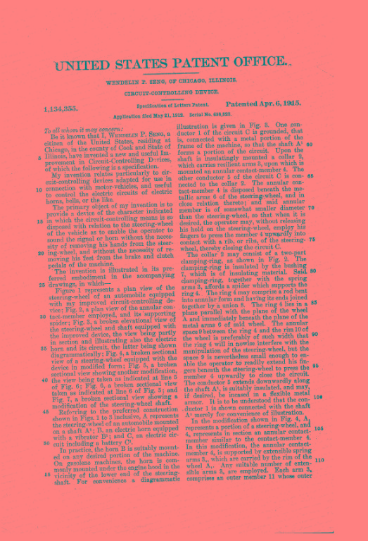

Is this any help? Non-T but maybe similar.

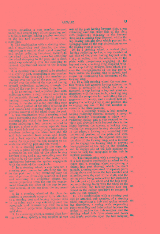

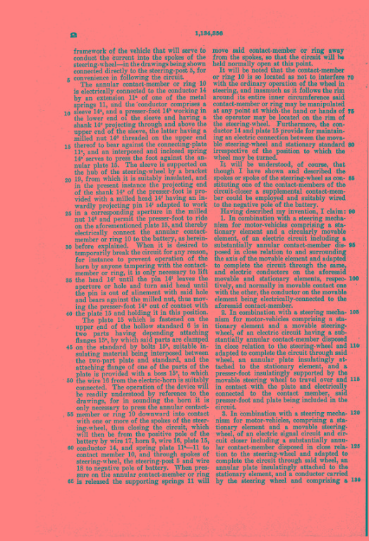

Post by John E. Guitar » Tue Apr 20, 2021 10:18 pm
One more.

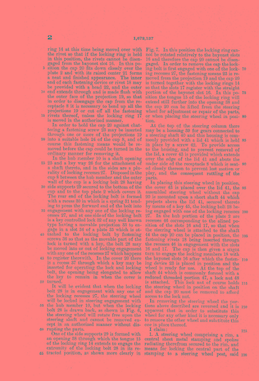

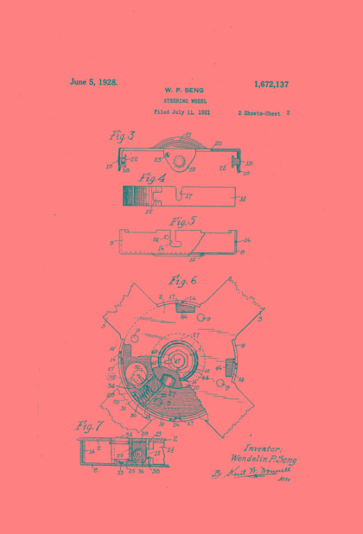

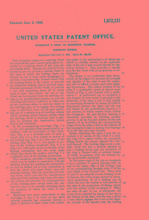

Post by John E. Guitar » Tue Apr 20, 2021 10:30 pm
Here is a locking mechanism.

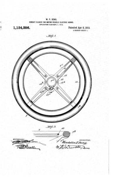

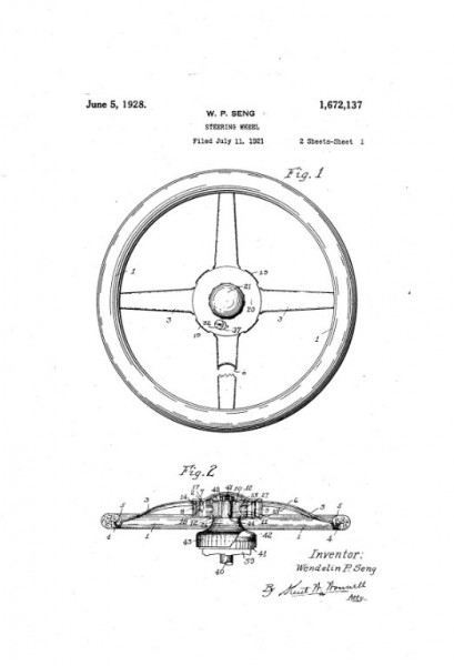

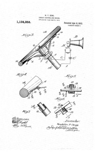

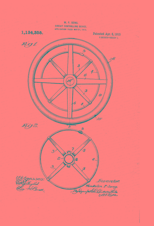

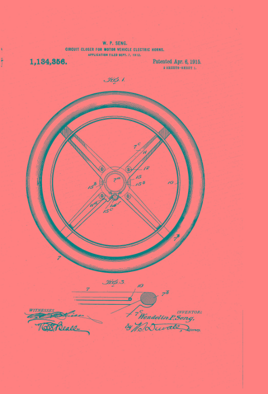

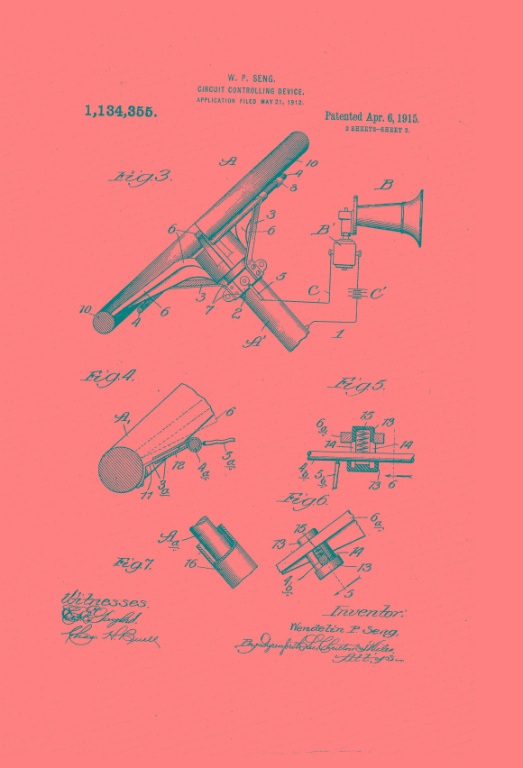

Here are pictures of the part that Rich is missing

Frank I kept looking at that first photo, thinking wow someone else moved their horn button to the other side so the turn signal could be mounted. Then I looked really close, oh that was mine. LOL
Before getting too in to the project, mock mount the steering wheel. What I found when I mounted the one shown above, it was too big and was just in the wrong place for my taste. Other then that because I only had it for a short time, I don't recall any of the details on how it mounted etc.
