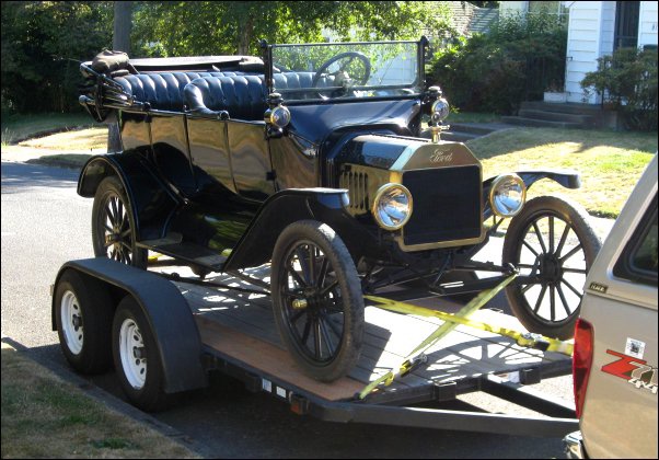

I just bought a 1913 Model T and I am going to pick it up this weekend. I have a large enclosed trailer so the car will be well protected, but I want to make sure it does not move around inside the trailer. I only have hooks in the corners of the trailer so I was planning to run the straps around the axles of the car to hold it in place inside of the trailer. I have hauled tractors and other cars this way, but looking under the Model T the axles look a little skinny and fragile....but then again it does not weigh very much. Any advice or words of caution about hauling a Model T this way?
Thank you.....

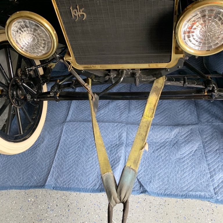

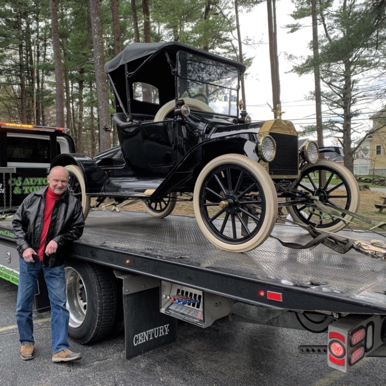

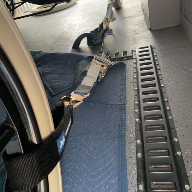

Transporting a Model T
Post by FreighTer Jim » Sun Apr 18, 2021 2:23 pm
I just loaded this 1915 Model T Runabout up
in Bolton, Massachusetts.
Going from one family member to another 😉
This trip will be unique 🤔
I have to pick up another Model T in
Michigan that is also going from one family
member to another.
Since 2006 - I have personally transported over
(400) Model T’s of just about every body style
and configuration.
A few years ago - I standardized tie down
Methods for all Model T’s & Early Brass Cars.
If the wheels - spindles - bearings are secure
and in good order:
Mac’s axle straps thru the wheels
Ratcheting nylon straps from the wheel
Back to the center of the vehicle in line
This holds the car together
This helps keep the car from “ walking “
Across the trailer floor
I have etrac installed about every four feet
Width wise across my trailer
FJ

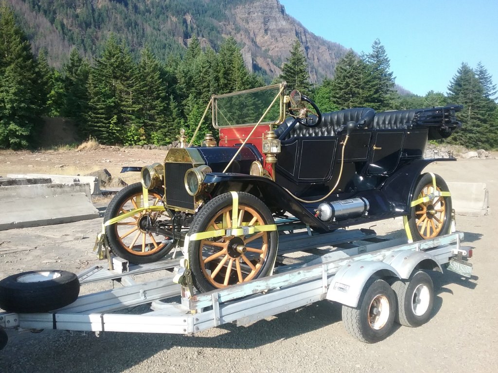

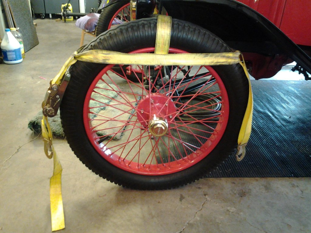

Re: Transporting a Model T
Post by BE_ZERO_BE » Mon Apr 19, 2021 1:28 pm

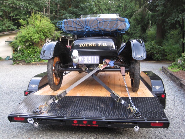

I had modern tire wheel nets when I first got my trailer.
I quickly replaced them with some off-the-shelf fully adjustable wheel nets.
The horizontal loop is adjustable and can reach around a T tire easily.
The top over strap is adjustable as well to keep everything snug.
I always check my tiedowns at every fuel stop.
 OLD WHEEL NETS
 ADJUSTABLE WHEEL NETS
