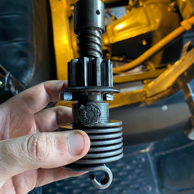

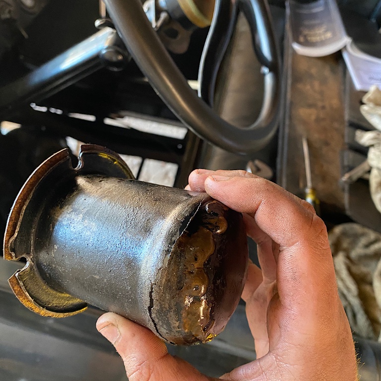

Bendix head spring screw is stripped, fell right into my hand. Bendix gear cover is cracked and that’s where the oil came out of. Pictures are too large to attach. Going to downsize then.

Not likely stripped. More likely worked out due to no lock tab. Interference with the cover on the way out broke the cover. Not a big deal.
Bendix likely usable with new screws (if necessary due to being bent) and new locking tabs (absolutely mandatory).

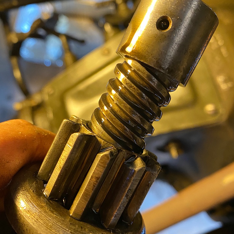

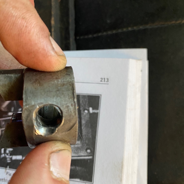

The screw is stripped. :(
https://imgur.com/a/af0zmtQ

If the woodruff key is missing, then all of the force of the starter is taken by the spring bolt, which is why the bolt eventually sheared. Find your original key and reinstall it, or get a new key. The key is what should take the starter torque, not the spring bolt.

Looks like the threads in the bendix head are gone and the hole out of round. Bendix gear itself is ok with one slightly chipped tooth and it turns freely in the shaft. :D
https://imgur.com/a/9sIgIuV

The picture you posted looks like the kick back bent the spring and that force stripped the mount bolt. If the rear drive is still keyed to starter shaft the spring eye should line up, yours is offset now. Pull the rear mount, don't lose the key, then pull the drive. Check parts for damage and replace as needed, check starter motor operation. Reinstall drive with replacement can if needed.

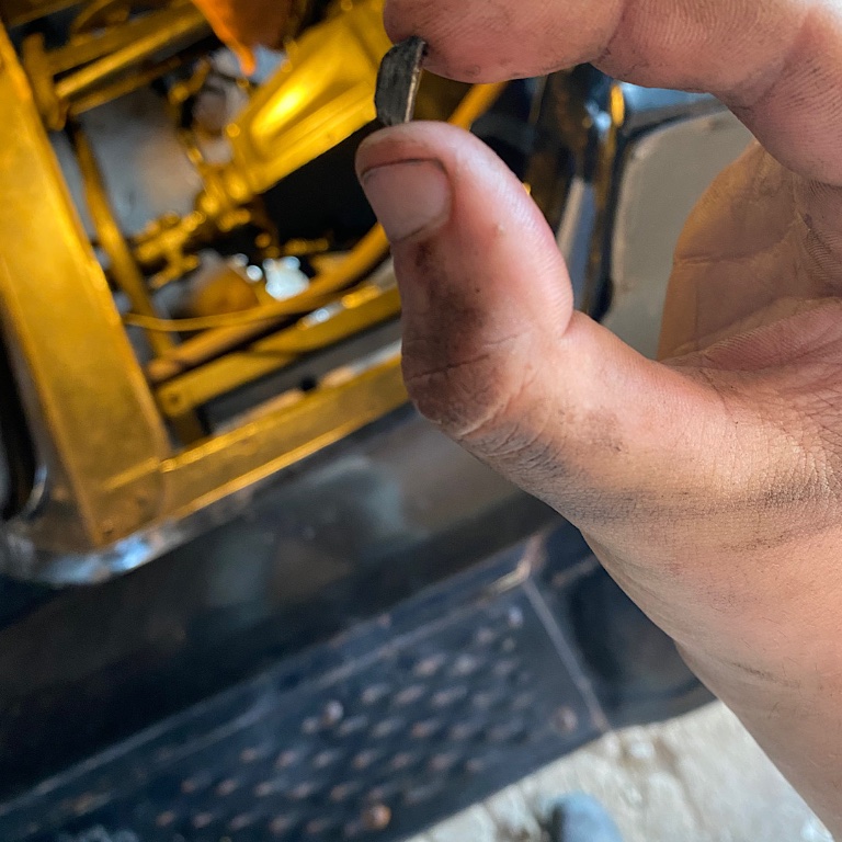

Looks like the key is too small? Like the corners are chipped. The spring does not seem to be cracked but it does seem to be very compressed.

I’m imagining I can just seal the crack of the bendix gear cover with some solder? I don’t seem to see any for sale.
Edit: Never mind, I found one!
http://www.snjparts.com/Model-T-Starter ... -3380.html

Glad you found a new cover. When you get the new spring bolts, be sure to get the OEM style with the thinner heads. Some of the repros have thick heads that rub on the inside of the cover, making a terrible sound and damaging the cover. Also, get new tab washers, you shouldn't re-use the old ones. I hope you're getting a new collar to replace the one with the wallowed-out hole. Good luck! :)

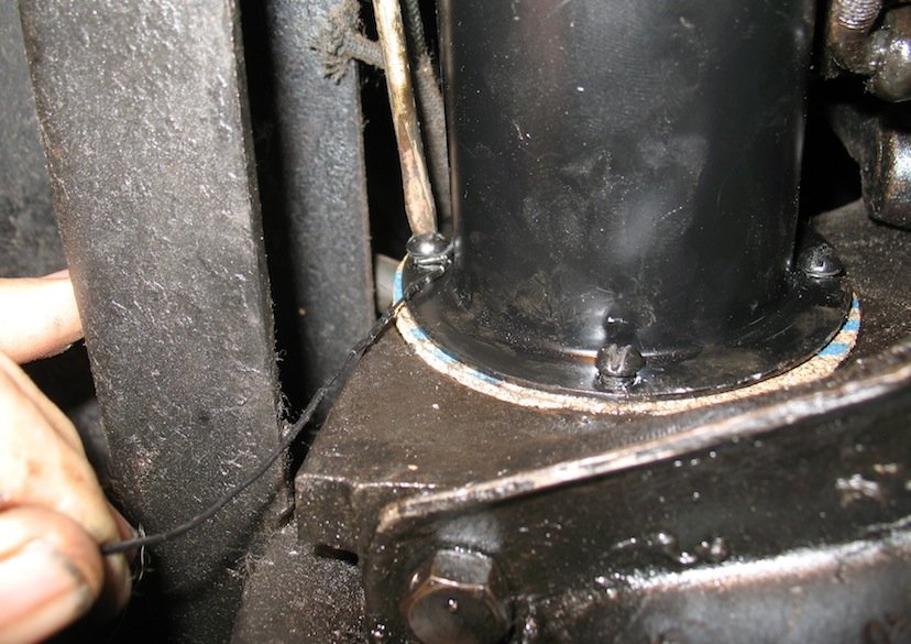

Just a quick comment to make your life a little easier. You may already know this but when removing the Bendix cover a lot of grief can be avoided by only removing three screws. Just loosen the one at the 3 o'clock position, don't remove it. The cover is normally slotted to slide behind this screw. It is quite difficult to install this screw with the cover in place. If you have already removed it, just install it loosely before you put the cover in place. Good luck!

Yes that screw at the 3 o’clock position was quite fun to remove! Once I get the bendix repaired I’ll check the timer firing positions and see if they’re all lined up or close to it. Better that Lizzie kicked back on the starter and not on my wrists! 🤗🔧

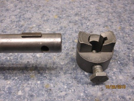

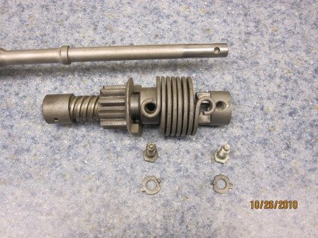

Re: Starter Not Turning Over Engine
Post by Steve Jelf » Wed Apr 21, 2021 9:13 pm
Don't lose those little cover screws. If you do you'll have to order them from one of the parts dealers and pay shipping. They are an odd size and you won't find them at a local hardware store. They're easier to get started with a wire handle.

I’ve kept the cover screws on Lizzie’s running boards. I like to get my hands oily working on Lizzie so I don’t mind starting the screws by hand! :D

I suspect you did not lose the woodruff key. I think it was not placed the last time the bendix was replaced on the starter shaft. So the entire force of the starter hitting the flywheel was on that bolt. It just happened to come loose at the time you last tried to use the starter. I think you can save the cover by sealing it up with solder or brazing it. Just be sure it does not leak because that's a location which gets a lot of oil.
The key can be found by taking the bendix head to any auto parts store and asking for a key which fits the slot. It will usually be just the right size to fit the shaft.

I ordered a new key from Lang’s Norm, I got the old one off but I figured it’s only a $0.50 part which takes the brunt of the starter’s force, might as well replace it. The key just flew backwards on to the garage floor when I went to grab the spring after removing the stripped bendix head. An older gentleman here on City Island has a couple of Model T’s that have been sitting in his garage for 30+ years (I had no idea they were here until very recently) and maybe I can convince him to swap starter covers in the meantime since it’s on backorder and not available currently.

You should be able to get a used starter bendix can from Model T Haven, they have many T parts for sale.
Posts: 7411
Post by Steve Jelf » Fri Apr 23, 2021 11:09 pm
The wire isn't for cleanliness. It's for holding the screw where I have trouble reaching with my clumsy fingers. :)
