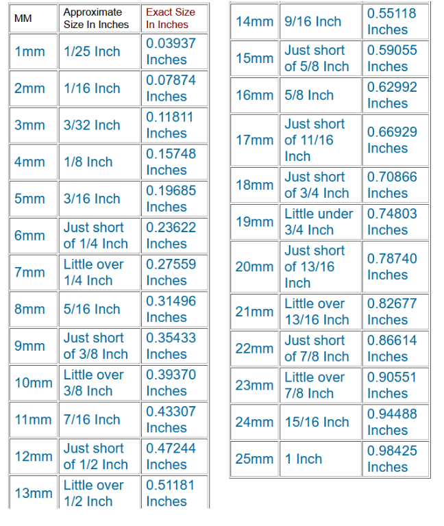

Post by TRDxB2 » Thu Apr 22, 2021 6:04 pm
There are only 3 countries that haven't adopted the "International System of Units" SI system (aka metric system) the other two are Myanmar(Burma) and Liberia. The 15mm size has been popular for ever, almost 5/8 inch. Having owned several German cars, 10,11,13,15 and 17 were the most popular sizes. If you buy something Today you shouldn't expect to be made to US sizes. The population of the US is only 4.25% of the World's population. In other words there are more metric wrenches than SAE

Australia went metric some 50 years ago No 15mm spanners was not a common size for us, although it would fit 1/4 whitworth. the most common one was 14mm which would fit 9/16" SAE and the 13mm would fit 1/2" SAE.

I collect and sell spanners, and come across some interesting examples. From the chart above you can see that some metric/imperial sizes do roughly equate. However, in my gathering I have found some beautiful quality German Stahwille brand metric spanners stamped with both metric and imperial sizes. Try fitting a 12mm end on a 1/2" nut!
There is a blessing in metric conversion for model T's. Both 8mm and 10mm are oversize to imperial equivalents of 5/16" and 3/8", so these can be used to make clevis/hinge pins to take out wear in components.

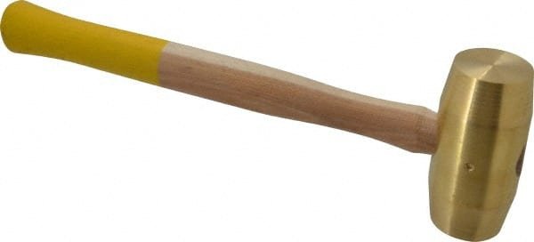

Post by Been Here Before » Fri Apr 23, 2021 9:58 am
The most important tool in the kit is an engineer hammer. It is designed to be used on all bolt and fitting sizes. One wack and the piece works. I find it best for carburetor adjustment ad float realignment.

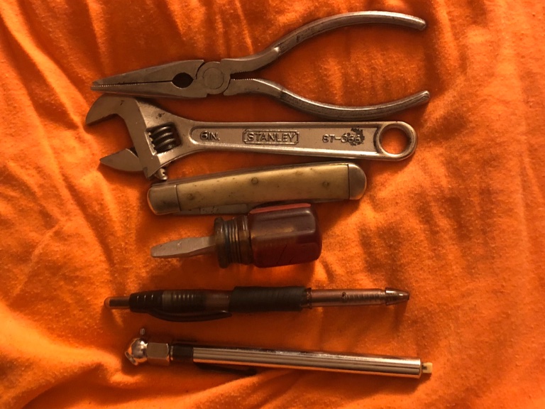

Posts: 7275
Re: Metric on a Model T?
Post by Allan » Fri Apr 23, 2021 7:13 pm
Corey, you can eliminate the screwdriver, needle nosed pliers and pen knife and add a pair of scissors, phillips driver, reamer and saw by carrying a Victorianox stainless steel multi tool. I feel lost without mine. my shifter is a 4" Sidchrome unit which opens to 9/16".
