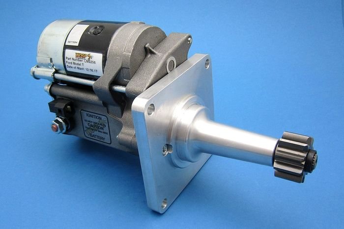

I originally installed a stock 6 volt starter and used it with my 12 volt system. I put the battery under the back seat and ran #4 wire to the starter which should have resulted in some voltage drop under load. With some misgivings, I followed the advice of some folks I respect and made a little pigtail from the solenoid (yeah, I used a solenoid) with an old bendix spring on it.
My observations:
Normally, it worked pretty good. It didn't sound like I was abusing the starter. On tours, I did experience a couple of instances where I or my friend (who helped me restore my car) stalled the car and the starter didn't seem to want to turn it over very well when hot. I have a Z high compression head which may have been part of the problem but someone would have to get out and crank the engine over off compression, then it would turn over and start with the starter.
I was on a tour last summer and the connector on my pigtail broke. Fortunately I had a spare pigtail without the old bendix spring. After installing it, I and my friend both thought it sounded like the starter was "slamming" harder than before.
With Covid, I had too much time to think so I decided to investigate 12 volt starters. Heck, my '17 didn't come with a starter so I'd already insulted the purists out there by putting one on. In addition to the issues described above I'd had bendix trouble on a tour in 2019 and decided maybe it was time to go modern. I ended up installing a WOSP 12 volt geared starter and have been very happy with it. It has a built in solenoid, no troublesome bendix and installs and removes easily. When you hit the key, the built-in bendix first engages the gear, then spins the starter. That way you aren't grinding the bendix gear into the ring gear when it engages. It sounds a little different and looks a little different if you open the hood but it works well. I still carry a few spare bendix parts with me, but just in case somebody else needs them :) WOSP starters don't cost that much more than a rebuilt original unit. I sold my old starter and recovered most of the cost of the WOSP.
