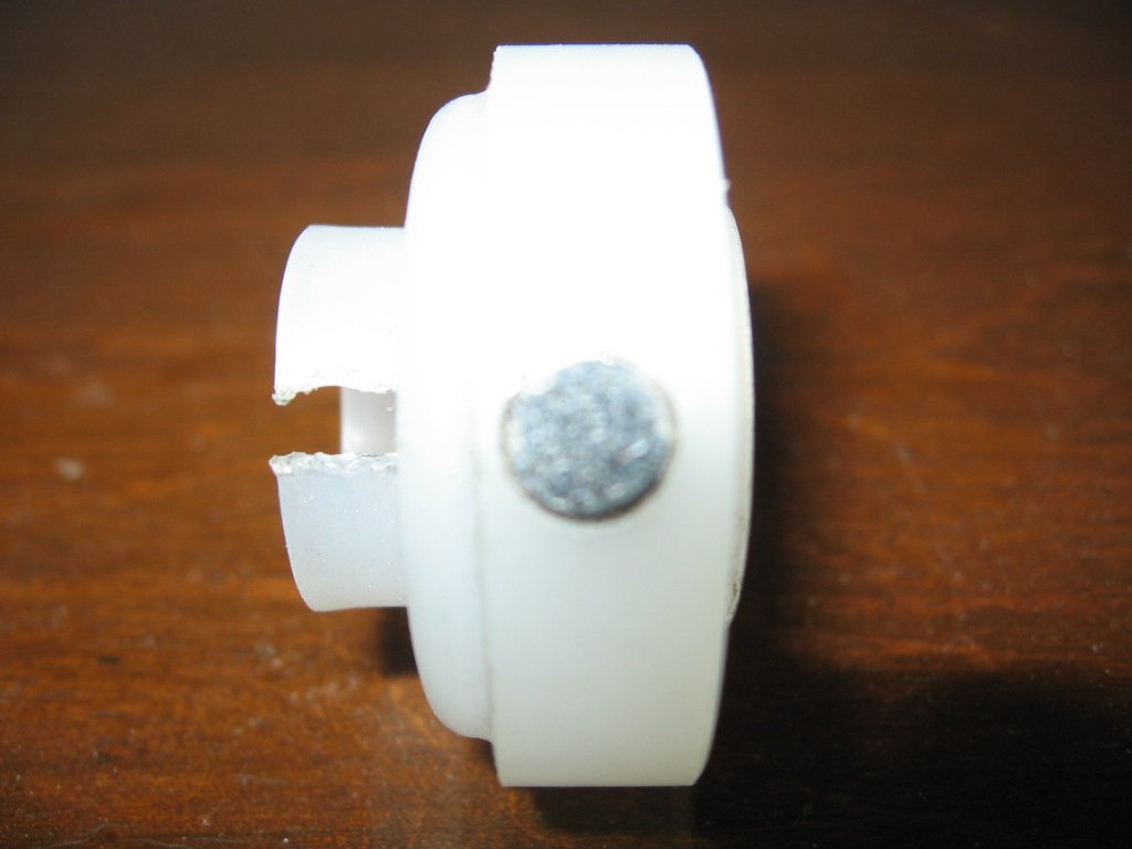

Re: True Fire ignition support?
Mark,
Just checked back with my friend, turns out the rotor is lost. By chance do you have a spare?
I've been in touch with Jim Golden, a wealth of information about the system. He sent me a variety of documents about the system and I have forwarded them to my friend.
Walt
Walt

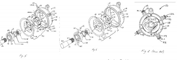

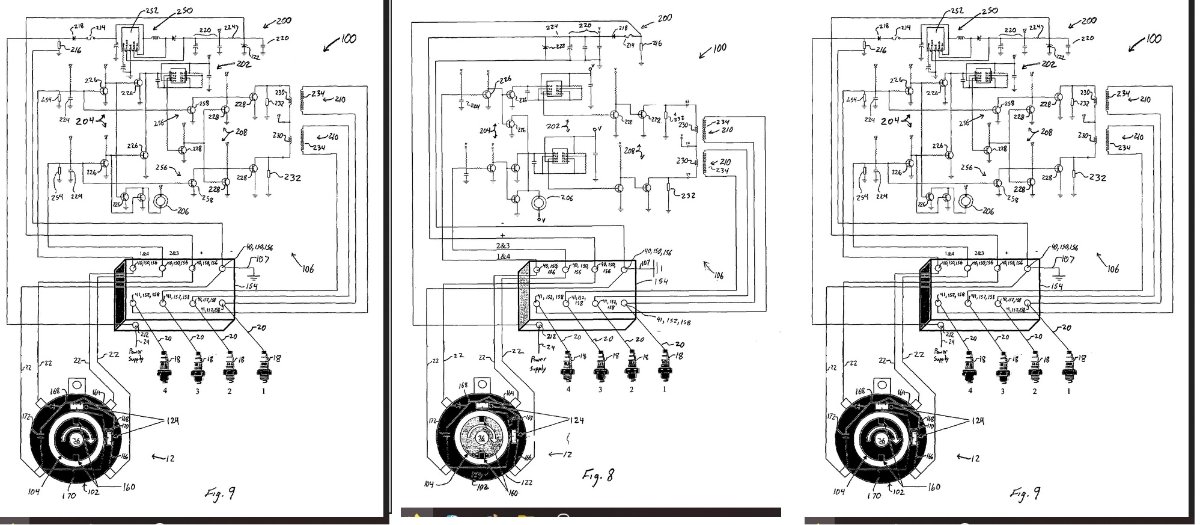

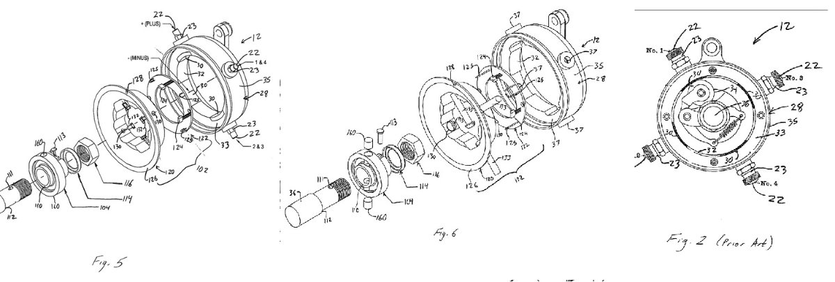

You might have missed this link that was in one of the past forum posts mentioned above https://patents.google.com/patent/US6976482walber wrote: ↑Fri Mar 26, 2021 1:38 pmMark,
Walt
It has the patent diagrams of the timer etc

Jim, if you still have those dimensions, could you publish them here? Somebody with a 3D printer could probably do a run of them.
I measure my rotor as 1 3/8 inches in diameter and 13/16 inches in height. It has two small cylindrical neodymium magnets embedded in the periphery, 180 degrees apart. One of the magnets is lined up with the slot in the nose of the rotor that the timing pin fits into. Each magnet is about 1/4 inch in diameter and 1/4 inch tall. They are pressed into the plastic so that they are flush with the surface.

I just checked, both cylindrical objects pressed in the rotor 180 degrees apart are strong magnets.

Both magnets on the rotor are south poles. The pointer on my compass points at each magnet when I draw it close. Is this vital to the operation of the unit? I have no idea!

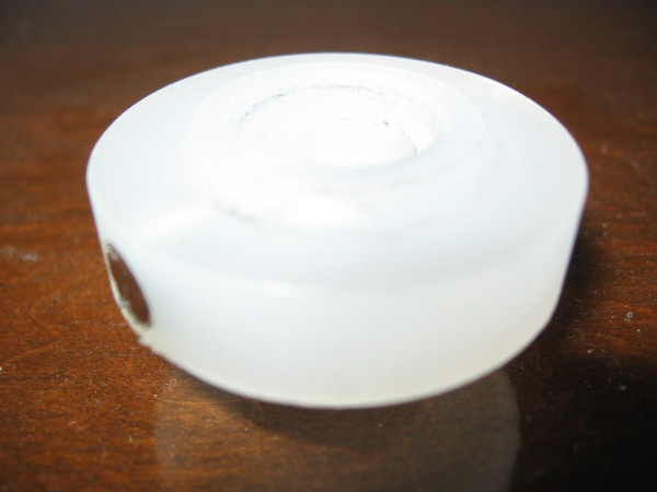

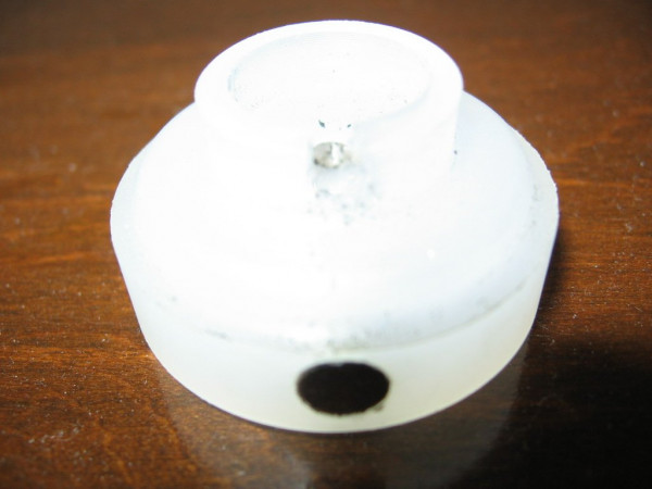

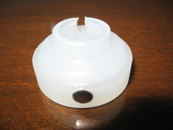

Bill Jensen here, friend of Walt Berdan near me...
With the info you all posted here, I am able to fabricate the only missing piece : the lost white plastic rotor with 2 magnet parts piece. The rest of my True fire can work again. I had removed it when I got my T, it was working. But it rolled away !
In reverting to wood coils I found spark gaps at about .045, rod lengths were wierd, etc etc. And my T would not hardly move in low gear.
Here is the information I got from you all here I needed :
A closeup picture of the white plastic, a reference dimension, notch and pin hole relative positions to magnets and rotor shaft, number of magnets, rough sizes, that they are rare earth neodymium, flush, and type of NS polarity pointing outwards to a needle compass ! I can now Make it !
Yayyyy Thank you forum please, I have not been able to post there. I thought a T had reverse, Lo Hi, 3 speed transmission, so I could not join.
Sincerely, a Very grateful, less demoralized new T owner...
Bill Jensen

walber
Topic author - Posts: 268
- Joined: Sun Jan 06, 2019 12:55 pm
- First Name: Walt
- Last Name: Berdan
- * REQUIRED* Type and Year of Model Ts owned: '18 Speedster had 25 touring and 26 coupe
- Location: Bellevue, WA
As Mark mentioned above, I've been working on making some replacement rotors. With a couple prototypes made and tested, I will be able to make a few more if there is any interest. I'll add a post on the Classifieds - Parts section of the Forum. In the mean time, if you have an interest you could contact me at wberdan at comcast dot net.

James, they are in series and connected together by the engine frame, look at the patent.
That makes the spark gaps have to be equal to equally share the spark.
The Ford Coil supplies about 9,000 AC Volts that is equally divided.
