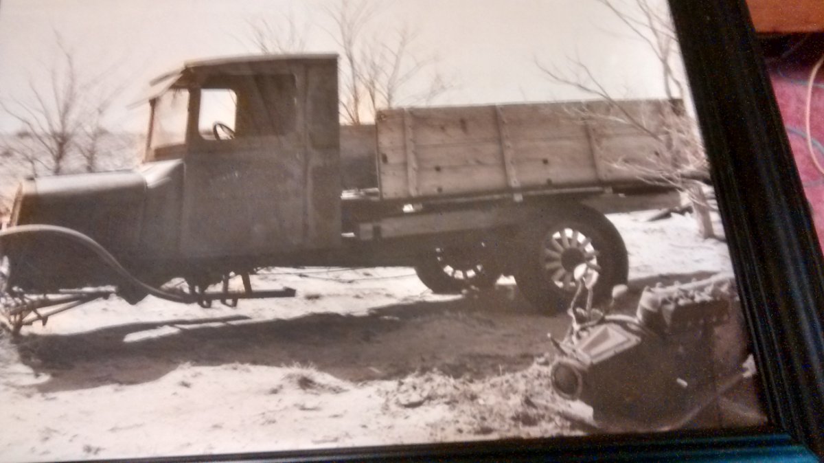

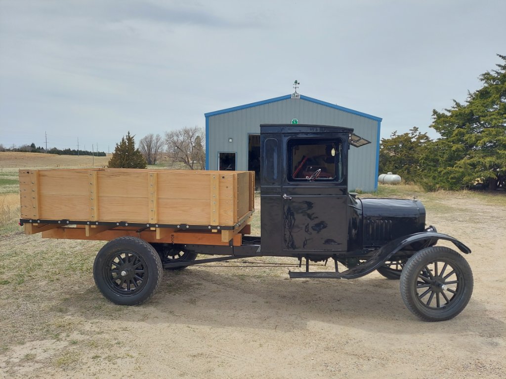

Re: 26TT first start
The day grandpa gave me his 26TT (circa 1960)
Good looking TT Rod. The before and after photos are great. Thanks for showing us. Now drive the wheels off and show what a real truck looks like.
