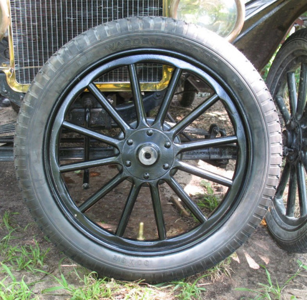

Re: Painting Wood Spoke Wheels
I used gloss black Rustoleum. No primer needed.
I think they turned out OK.

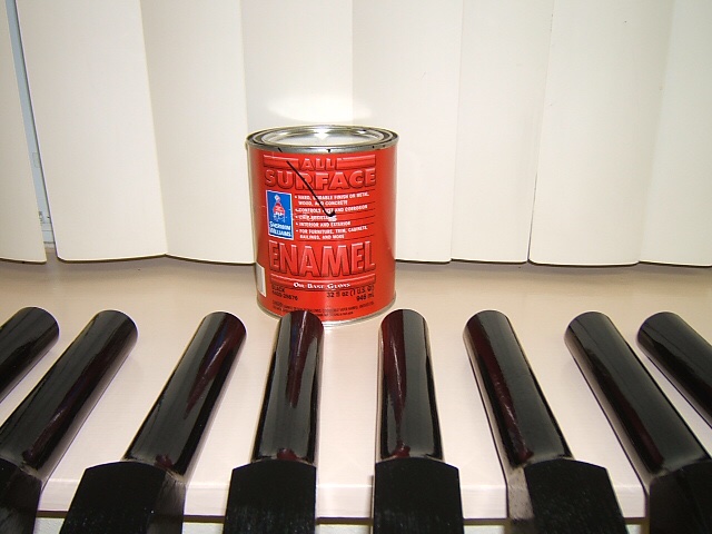

In my opinion, the best oil based wood primer and oil based high gloss black enamel for wooden spokes are by Sherwin Williams. If you have steel felloes, they should be primed with red oxide primer and painted with the same high gloss black enamel pictured. All of these coatings can be applied using a good high quality 1” artist brush and will dry without brush marks. You can see my spokes that I brush painted and how smooth and shiny they are. Best of all, they are a deep, rich, jet black. Jim Patrick
