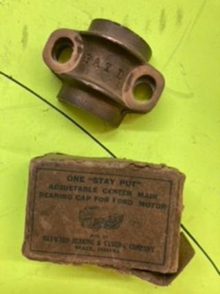

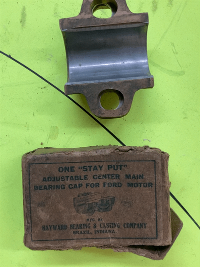

Craig Leach
Posts: 2036
First Name: craig
Last Name: leach
Location: Laveen Az
Re: Rear main cap removal advice
Post by Craig Leach » Sat May 01, 2021 3:45 pm
Allen
The cap is brass so it gives a more robust surface to wear against. It alos has a way of locking it in place to get the mag ajusted.
Made by the Hayward bearing and casting Co. Called the "Stay Put" adjustable center main bearing cap for ford motor.
I'm having trouble sending pictures to my comtuter.
Posts: 7292
Post by Allan » Sun May 02, 2021 7:32 am
Craig, I was not aware that the cap was brass, but it still does not compute with me. You report that it is stated that it wears better, but in the absence of a thrust face ground on the crankshaft, what does it wear AGAINST? There is no thrust face on a centre main cap and no thrust face ground on the crankshaft. I must be missing something. Or does it just fill a gap like the temporary brass item sandwiched between the fan pulley and the front of the block, and wear against whatever?

Craig Leach
Posts: 2036
First Name: craig
Last Name: leach
Location: Laveen Az
Post by Craig Leach » Sun May 02, 2021 3:52 pm
I would assume that there is enough suface in & past the radius of the center main journal to hold the crank in place. Don't think it would be wise to set it up any tighter than you would the 3rd. main. This is just a stop gap repair I would not think it smart if you are not sure the rest of the engine is up to the task. As I understood this was intended to keep the Mag. working? When I purchased the engine in for My speedster I was told it was probably
rebiuldable. I didn't. In the next 7 years I replaced the valves, lifters, head, 2 rods, and the bands. ran the cr@p out of it but didnt pull the engine untill I cracked the low drum. The more knowledge I gain from working on T's the less fun & more worry I have. Some times I think we over complicate one of the simplest cars ever made.
