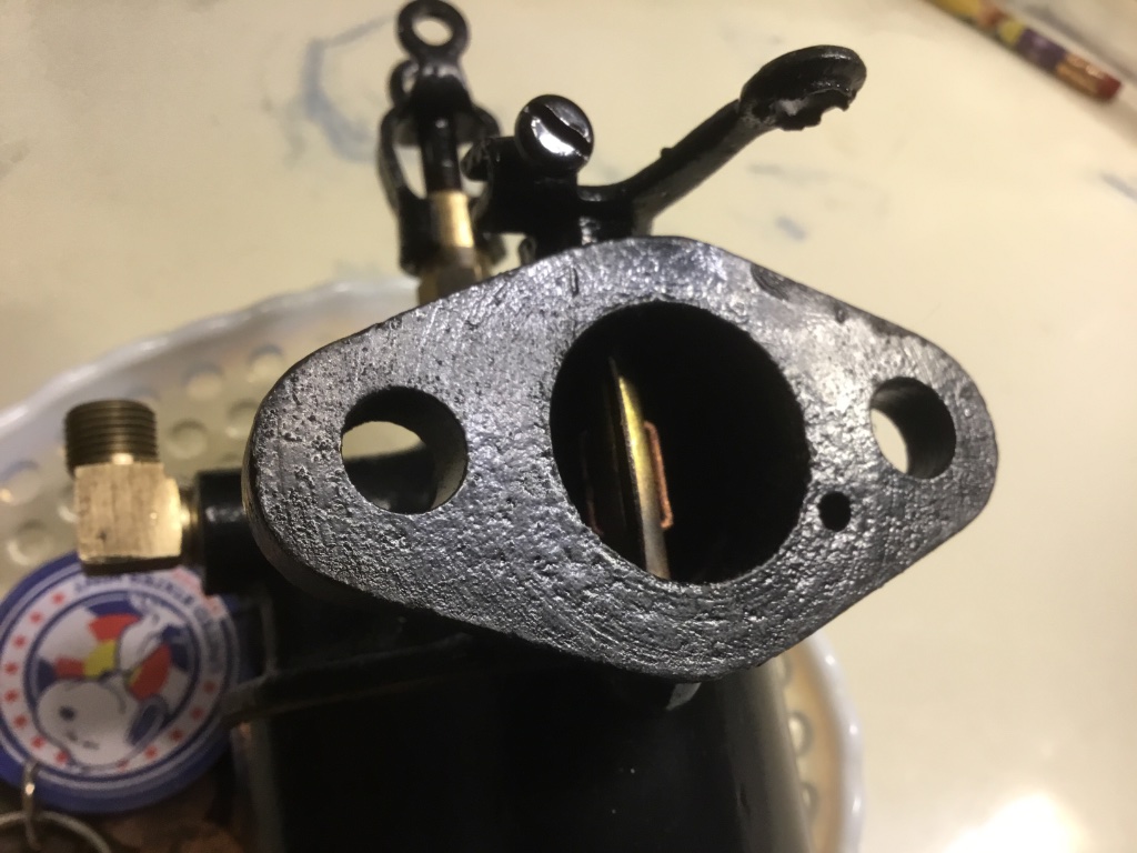

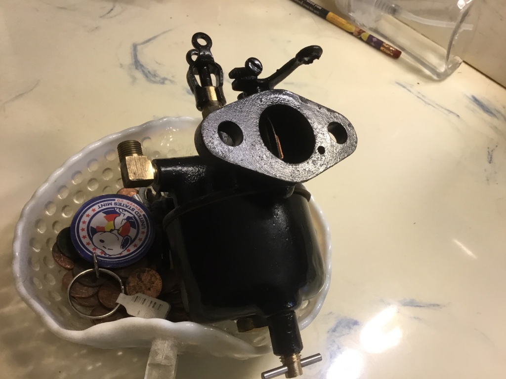

Looks like the gasket will seal off the passage, so is there any compelling reason to plug the hole?

Whether it gets plugged or not, I would pass a file over the face of the flange to clean it up and insure that it's flat. With what looks like some fair pitting between the plug hole and the throat, I might be concerned with a leak path, were the hole left unplugged.

Let me be clear about this, the hole had a brass plug that I removed along with the other two. Of course the other two had to be repluged after the passages were cleaned. But,
I’m thinking the gasket will seal the passage just fine??

For yourself, go for it. It will run fine so long as you use a modern soft paper gasket. If you use an original brass-clad asbestos seal there would be some risk of (probably undetectable) leak due to the pitting on the face of the flange.

The hole is too close to the carburetor bore to expect a gasket to seal it. Exactly why was the passage drilled? Is it certain that it needs to be plugged for all applications?

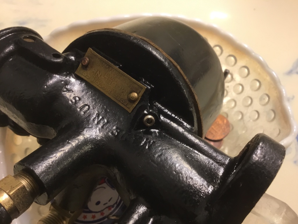

The passage is where fuel flows from the bowl to the back side of the butterfly. It provides fuel at idle. There is a good diagram of passages on modeltfordfix if you want to see it. I used a piece of a brass screw to plug the hole. It was easy to do. I've also used threaded plugs (set screws).

I'd plug it securely with a plug similar to other plugs in the carburetor body, then file it flat with the gasket surface. It looks to me like it's too close to the main bore to tap. I'd use a lead or soft brass plug.

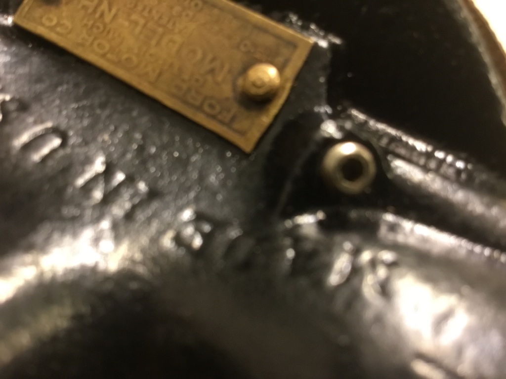

Thanks for the input. I was going through a corner of the shop and found a 5 gallon bucket of NH bodies, my Dad and I gathered up in the early 60’s. They still had the wire my Dad tied on them to hang them on the shop wall, this just about melted my heart. Anyway, Two of the bodies have brass plugs in the top and bowl area but not the gasket area. Back in the day we didn’t know anything removing the plugs and cleaning the passage ways, so if a old mechanic did remove the plug —-you get my drift. That’s the origin of the question. I use the tap and threaded stainless plugs to make it easier for the next guy. Anyway thanks for all the responses.
