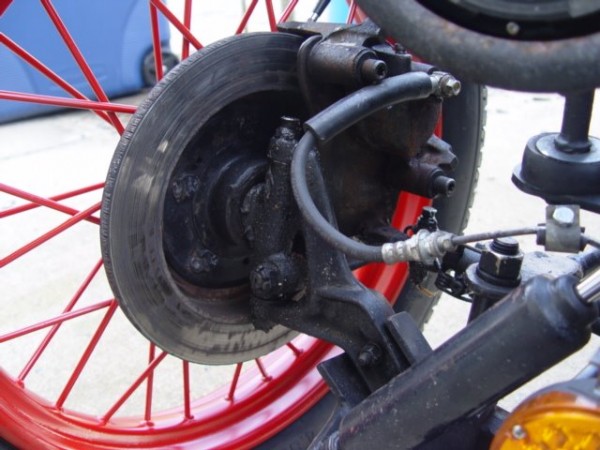

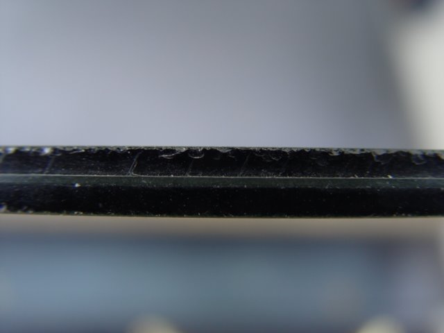

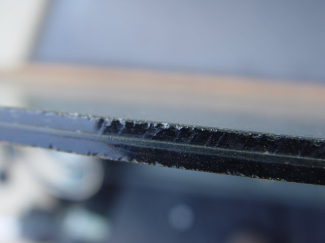

In the State of Virginia, if one is going to use a vehicle for "daily driving", it has to be inspected. That is the law and I approve. If a vehicle is over 20 years old one can put antique tags on it and skip the inspection, but that vehicle can not be used as a daily driver.
My speedster is a daily driver, and I drive it weather permitting i.e. not raining and over 40*. It is the vehicle I drive the most, it is a blast to drive. I have gotten the annual inspection three times, and always passed no problem. I want a tight inspction because I want it safe for me and other drivers. I have been seen by probaly hundreds of local police, some even give a thumbs up. I have also been seen by many State Police, and I think that they respect the fact that I go to the trouble to get a State inspection.
Today I went for a walk in the park and when I got back to my car there was a State Policeman who said my car shouldn't pass inspection for three reasons:

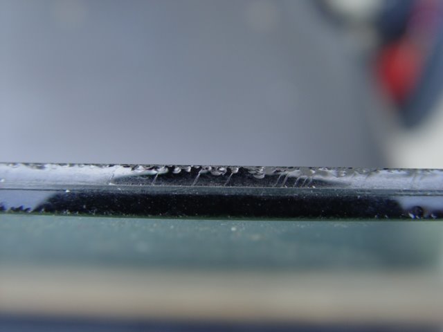

The windshield is some type of plastic, not safety glass. I think he is correct on this, and replacing the windshild with safety glass should be easy.

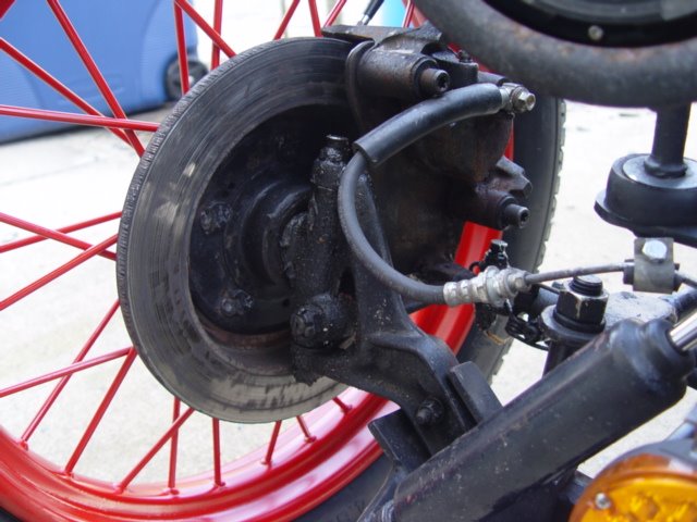

Since the car did not originally have front brakes, it can not have front disc brakes now. Only original equpment is allowed. I pointed out that it does have the origianal parking brake and original transmission brake, both in good working condition. He said that did not matter, I am not allowed to have any braking system that did not come on the car originally. I think he is wrong on this.

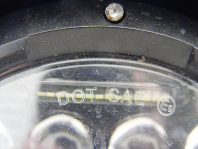

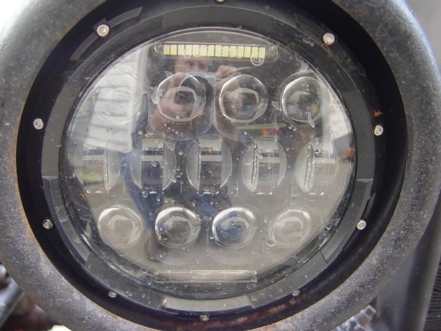

I have replacement Jeep headlights marked DOT SAE. The officer says I need original Model T headlights, and that no LED headlights are allowed if they have more than six lamps, mine have a lot more than that. And, I am not allowed to put Jeep headlights on a Model T. I asked if I could put original lights on which are inadequate for running 60 after dark, and then use the DOT SAE headlights as auxillary lights. The officer says no, I can only have original headlights on the front of the car. I think he is wrong on this.
A Virginia State Policeman who specializes in State Inspections is going to call and hopefully I can get him to come by my house and inspect both the speedster and Ellie Mae which is close to being on the road. She too will be a daily driver.
My goal is to have a vehicle which is safe to drive on modern roads (not Interstates) on a daily basis. I am basically law abiding and I thought I was doing things correctly. Time will tell.
Has anyone had a similar experience or suggestions.

I hope no one interprets anything I have said so far as bashing.
I think the officer is correct about the windshield, so I went by Safelite. Safelite does not do flat glass.
I found a shop that does do flat glass and I have an appointment to see them later this afternoon. They said that a legal windshield in VA has to be laminated, my present windshield is not laminated that I can see. If my present windshield is not legal I want to replace it. BUT, the present windshield has passed state inspection at two different shops over the years, so?
I called the shop that did the last inspection and they said to wait on getting the windshield replaced, and that the best thing is for me to bring my car to the shop and meet with the State Police there. So, if the police contact them they will call me and we will go from there.
I want a safe vehicle, and I feel I have gone the extra mile to make mine safe, but I might have to go another mile...

I went to the glass shop. They say the windshield is safety glass, the same as they would put in if they replaced it. I does not have a "bug", probably because it was put in before bugs were required.
I went to the inspection station. It turns out that the officer who told me my car would not pass inspection is a Sergeant and he sent one of his men out to the inspection station to have a little talk about passing cars for inspection that had plastic windshields. I told the inspector that the glass shop said it is safety glass, not plastic. The inspection station would like a letter to that effect, so I went back to the glass shop and requested one. The owner of the glass shop, one of three there who looked at the windshield and said it is safety glass, won't be back until tomorrow. He is the only one who can write the letter.
The Sergeant also said the DOT SAE Jeep replacement headlights were not legal, I have to have Model T headlights. I think most would agree that Model T headlights are definitely not sufficient for running 60 mph at night. The policeman whom the Sergeant sent out told the inspector that the headlights had to be DOT. They say DOT SAE right on the lense. I showed that to the Sergeant yesterday when he questioned them. I was very careful to buy headlights that are not "off-road", but there might be a problem with the fact that they have more than 6 LED lights in each headlight. I am still a bit confused on this.
The Sergeant also said I can not have disc brakes, I have to have original brakes. The Policeman who went to talk with the inspection station did not say anything about the brakes. The car has an original working transmission brake along with the four wheel disc brakes.
I like to know that things are correct, legal, and safe. I hope the inspection station and the Policeman can get things straight. If they don't I intend to drive over to State Police Headquarters which is about ten miles from here, and try to find someone who can tell me what is allowed and what is not.

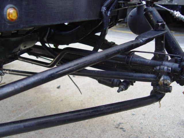

The offending disc brakes.
The Sergeant told me I was not allowed to have the disc brakes on my speedster, I could only have original brakes. I do have the original transmission brake and it is fully operational, adjusted so that it barely pulls in when the disc brakes engage. If the disc brakes fail I will have full transmission braking to the rear wheels.
The Officer whom the Sergeant sent to the inspection station did not say anything about this to the inspection station.
Here is a picture of one of the front disc brakes, and a picture of the split wishbone doubled up. If you have front disc brakes you definitely want to double up the wishbone to support the front axle. I recommend four wheel hydraulic disc brakes for anyone who drives over 45 in traffic. I always allow considerable stopping distance in any vehicle I drive, but the brakes on my speedster are good enough that I do not feel I have to allow any extra stopping distance beyond what I normally do.
I think the Sergeant is incorrect on this one.

The offending headlight.
Here are a couple of pictures of the offending headlight. The Sergeant said that each light in the headlight counts as one light and there "are more than I can count". He also said I can have a maximum of six lights on the front of the vehicle, and I cannot have a replacement Jeep headlight. The headlight has to be original to the car.
This morning I noticed a number of cars on the road with a lot more than six lights on the front if you count each LED as a separate light, including a Nissan Rogue and a Chevy Cruze.
Also please look carefully and notice the DOT SAE in the lense of the light. Can a headlight have the DOT designation if it is not street legal?

The offending windshield.
The Sergeant told me the windshield is not legal because it is plastic, it has to be safety glass. He sent a Policeman to the inspection station to tell them that my windshild is plastic and should not have passed inspection.
The glass shop told me the windshield is safety glass, and that it was probably installed before the law required a "bug" on the glass indentifying it as safety glass. The glass shop does not want to write a letter to that effect, they do not want to get involved. I don't blame them. But I don't want to replace a windshield that is perfectly good.
Does the law require Safety Glass, or does it require Saftey Glass with a bug? How about if the windshield was installed before bugs were required.
The picture is of the top edge of the glass. Is that plastic or laminated Safety Glass?
I am still confused about all these issues and will post as I go along, but for now I will lay low and wait for the State Police Officer to contact me.

That's safety glass. The shop that did the work should be ashamed to have charged for that.

I read the following from the Code of Virginia, and it looks like windshields have to be Safety Glass, but there is no requirement for a "bug" designating it as such. If I am reading it wrong, hopefully someone will correct me...
§ 46.2-1056. When safety glass required.
It shall be unlawful for any person to drive on any highway a motor vehicle registered in the Commonwealth and manufactured or assembled after January 1, 1935, and designed or used for the purpose of carrying persons for compensation or hire or as a public conveyance to transport school children and others, unless such vehicle is equipped with safety glass wherever glass is used in doors, windows, and windshields.
It shall be unlawful to drive on any highway any motor vehicle registered in the Commonwealth, manufactured or assembled after January 1, 1936, unless the vehicle is equipped with safety glass approved by the Superintendent, or meets the standards and specifications of the American National Standards Institute, Incorporated, or the regulations of the federal Department of Transportation whenever glass is used in doors, windows, and windshields.
The term "safety glass" as used in this section shall mean any product composed of glass so manufactured, fabricated or treated as substantially to prevent shattering and flying of the glass when struck or broken. The Commissioner shall maintain a list of types of glass approved by the Superintendent as conforming to the specifications and requirements for safety glass as set forth in this section and shall not issue a license for or relicense any motor vehicle subject to the provisions herein stated unless such motor vehicle is equipped as herein provided with the approved type of glass.
No glazing material other than safety glass shall be used in any motor vehicle registered in the Commonwealth, except that the Superintendent may permit safety glazing materials other than glass to be used in lieu of safety glass in portions of motor vehicles, trailers, and semitrailers designated by him, provided any such material bears a trade name or identifying mark, and has been submitted to and approved by the Superintendent.
If any person drives any vehicle in violation of this section while under a certificate issued by the State Corporation Commission, in addition to the penalty provided in § 46.2-113, the certificate of such person may, in the discretion of the State Corporation Commission, be suspended until this section is satisfactorily complied with.
Replacement safety glass installed in any part of a vehicle other than the windshield need not bear a trademark or name, provided (i) the glass consists of two or more sheets of glass separated by a glazing material, (ii) the glass is cut from a piece of approved safety glass, and (iii) the edge of the glass can be observed.

Thanks. No doubt it is Safety Glass. I think the only remaining issue is that my Safety Glass windshield does not have a "Bug" identifying it as Safety Glass. So, if my windshield was installed decades ago when a bug was not required, do I have to replace it now? Is it "grandfathered in"?

12. – INSPECT WINDSHIELD AND OTHER GLASS FOR:
Approved type safety glass.
Cloudiness, distortion or other obstruction to vision.
Cracked, scratched or broken glass.
ALL UNAUTHORIZED STICKERS MUST BE REMOVED.
Sun shading material on windshield displaying words, lettering, numbers or pictures that does not extend below the AS-1 line is permitted. In the absence of an AS-1 line, sun shading material on the windshield displaying words, lettering, numbers or pictures cannot extend more than three inches downward from the top of the windshield, unless authorized by the Virginia Department of Motor Vehicles and indicated on the vehicle registration.
Operation of left front door glass
From VA State Inspection Web Site
I do not see anythig about a bug. Just that it be approved type safety glass, ie: laminated glass for windshield as opposed to tempered glass. Yours is obviously laminated glass. No problem.
