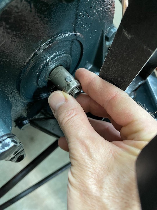

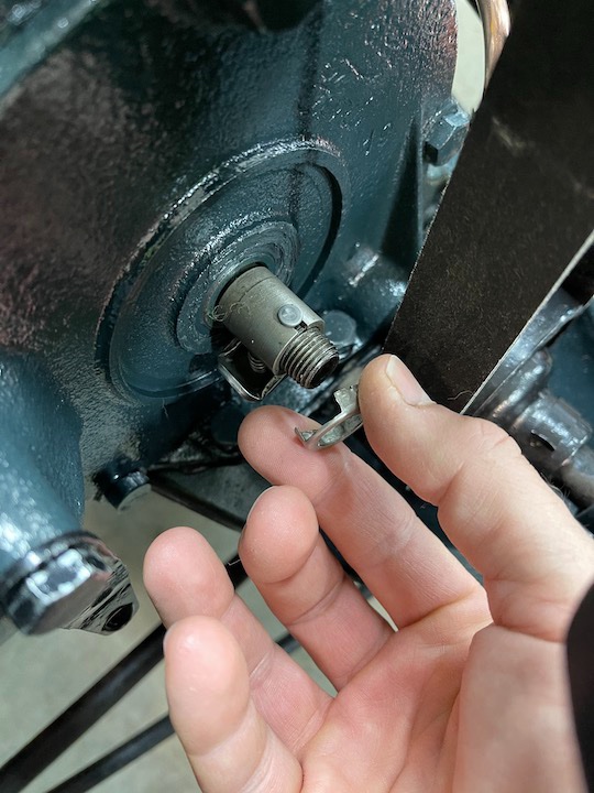

So I'm installing an ANCO Timer and I want to make sure I'm doing this correctly. I have already installed a modern cam shaft seal and centered the cam shaft cover with a centering tool. So the first thing I did was slip the "roller" on the shaft. Then I placed the pin in the shaft. My question is the washer seems to have a space for the head of the pin but won't slip easily over the pin. Do I tighten the nut forcing the washer on? How tight should the nut be?
Here is the washer

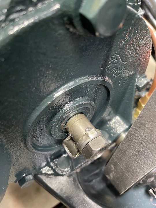

With the nut finger tight. You can see if I put a wrench on it it would force it on.

Tighten her down - I use Blue Loktite.

How tight, snug and you should not need any lock-tite of any kind.

I know Lock-tight wasn't around in 1926 and they probable just made it snug. In this case I wouldn't want the nut to come off. Will it? Not sure but why take the chance. You can still take it off using the blue lock-tight and it will hold better.

Robert, make sure your flapper moves freely. I put a new Anco on my ‘26 and had to file the slot in the pin retainer where the flapper rotates for clearance.

I pushed down on the flapper and it seem to spring up and down ok.
