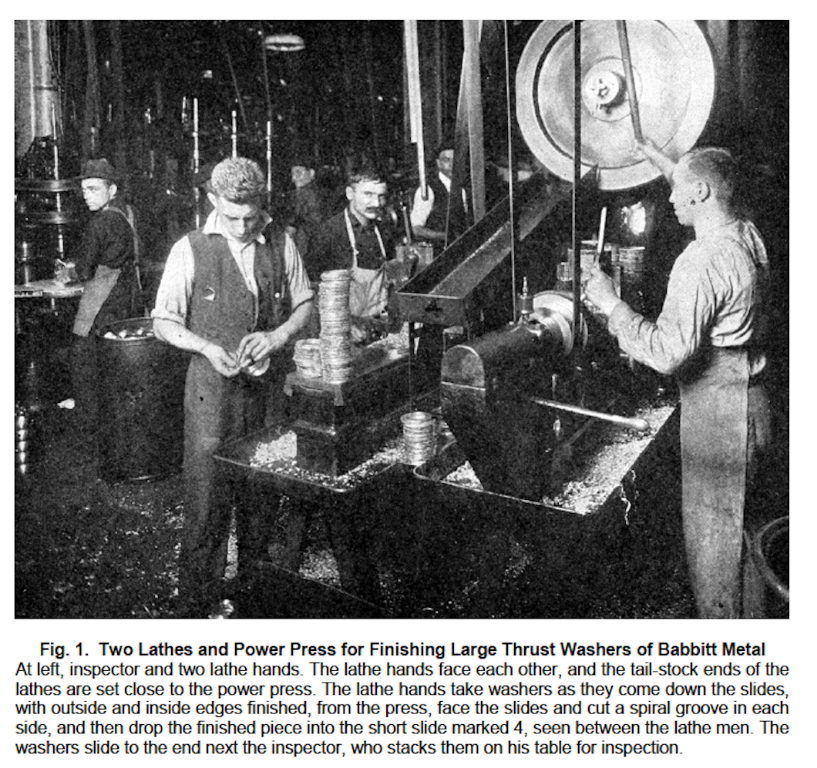

From 1914-15 Ford Methods and the Ford Shops:
- Posts: 7411
Re: babbit thrust washers
Here's the large print version for us elderly readers.

As the thrust washers were supplanted by bronze in 1915, we might confidently assume the early ones were indeed a true babbitt alloy. The clipping above showing machine methods on babbitt washers would seem to attest to this.
