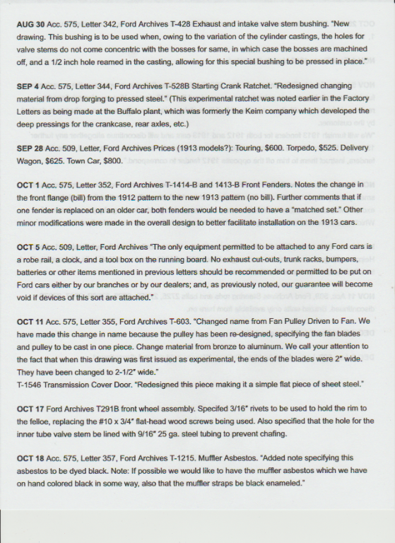

Robe rails however did sell in good numbers, and many original survivor cars have them still.

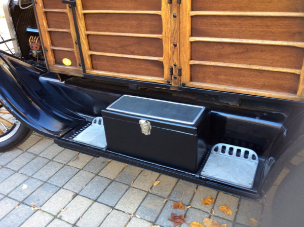

Some people ( like me) love accessories, Larry. Step plates can easily be installed without drilling a hole. Here are my ORIGINAL set of 4, installed without drilling and easily reversible. Just ask how, if interested.
Dropacent
- Posts: 3384
- Last Name: Morsher
- Location: Norwalk Ohio
Re: Brass car original bling
By the way, before Larry has a heart attack , the tool box is also installed without drilling any holes! I could never personally drill a hole in an original car ( or station wagon)

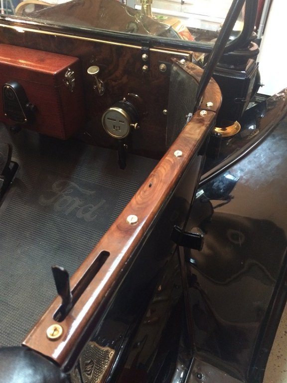

This is my '12 during restoration and the robe rail is clearly visible. It's mounted to the specs below.

Anyhow, both of the earliest appearing running boards I had were not, shall we say, in the best of condition. I had to replace a small area on one of them that had rusted completely away (a spot near two inches square!). The other required significant repair in the area hidden by the side apron. (It would have been easier to have simply used a couple of the nicer running boards I had!) Despite the two areas requiring significant rust repair, otherwise the two running boards were not all that bad rust-wise. However, in addition to the rust repair, both had a bunch of extra holes drilled into them for who knows what had been bolted down when?! One had about eight extra holes in it. Four of which were 3/8 inch size holes! (I cut out steel plugs and brazed them into place, to reduce shrinkage issues.) The other running board had all smaller holes, but more of them! (About a dozen! Most were welded, then hammered.)
So, yeah, I think holes can be repaired.
But I still do not care for step plates on model T Fords!
There are also noticeable differences in the stamping (shape and depth) of the "Ford" script.

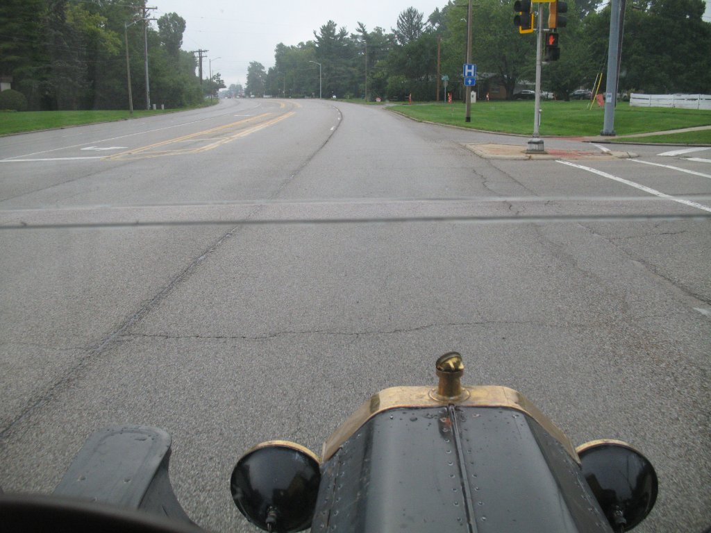

KWTownsend: noted your comment on the radiator wings. I reported this several times in the past and others said I was wrong. I had the same problem with my 12 and a Brassworks radiator. Changed to a dogbone and haven't had a problem in years. Just my .02. Dick C.
SurfCityGene
- Posts: 681
- First Name: Gene
- Last Name: Carrothers
Dick, I didn't see the post you referred but my radiator neck came loose once on my BW radiator while using the larger winged cap. I sent it back for repair and they added additional support inside. I now use the smaller winged cap which has much less wt and leverage. The '12 neck was not riveted so many times prone to cracking loose with a bit of abuse on rough roads or vibration.
1912 Torpedo Roadster
- Posts: 7411
Gene isn't the only one who's had a radiator neck broken off by a Motometer. The stock brass radiator cap is good enough for me. But after this little advenure I do make sure it's screwed in good and tight.

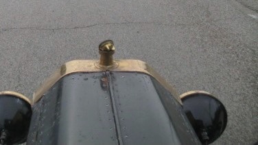

John Heaman
- Posts: 293
- Joined: Mon Nov 23, 2020 3:22 pm
- Last Name: Heaman
- * REQUIRED* Type and Year of Model Ts owned: Canadian 1912 Ford Model T Touring
- Location: Canaduh
The cap looks very jaunty like that! I run the stock cap as well.

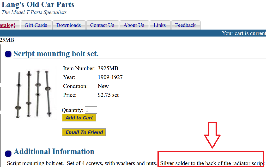

I purchased a nice scripted brass FORD logo to mount in the middle of my radiator. It came with no instructions or mounting ideas. How are people attaching these nice brass scripted logos to their radiators?
- Posts: 6587
Here's how. Need to be careful nothing rubs on the fins due to vibration. Not sure if there are alternatives to securing the washers to the radiator fins like a little JB Weld on the back of the washers (front & back washers)
