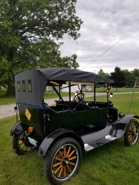

The instructions I've found online are really poor, as is the written material provided with the tops. My recommendation would be to see if you can find someone familiar with such installations within a reasonable distance and have a pro do it. Short of that, there have been a number of discussions on the subject so I would check the archive.
I have a '17 which shouldn't be too different.
Here's what I learned:
1.) Check your bows carefully. I had to replace mine. I also cleaned out the sockets, digging out the rotting original strengthening sticks. I then poured resin into them for strength and rust protection.
2.) Wrap your bows on the bias - My wife sewed the fabric into a sleeve that slipped on then I shrank it by wetting and heat. My front bow was wrapped in vinyl. I had to do that in three pieces and glue it on.
3.) Make absolutely sure the bows and sockets are properly positioned. my "guy" used wire and boards to brace them.
4.) Once the bows are in position install the webbing and pads
5.) Install the back piece first, then the front. Do it on a warm day when you can stretch the top. You might want to let it sit a day to be sure it is in the correct position before doing the final attachment.
Here are a couple of photos... look closely at the bracing.
Having it done by the 22nd might be a bit optimistic but you should be able to do it in it's 100th year
Good luck!
