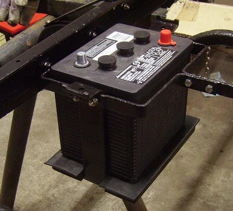

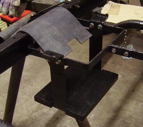

I know this is almost as bad as asking the oil question but I noticed that the battery cage on my 26/7 touring had the top part bracket disconnected from the frame on one side. When I put it back I noticed that the cage will only accept a battery about size 9 3/4 wide. Is there a 6 volt battery that will fit. I think the last guy who ran the car must have unbolted the bracket to fit the battery.

Group 1 top post 6 volt. You will have to add a spacer board on the bottom so the clamps hold it down.

I use Optima batteries these days, but a regular 6V battery will fit. However, there are two sizes I have found available at auto parts stores & tractor supply stores. You need the smaller one.

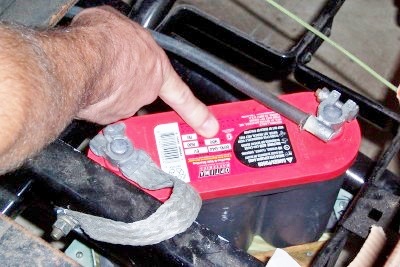

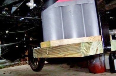

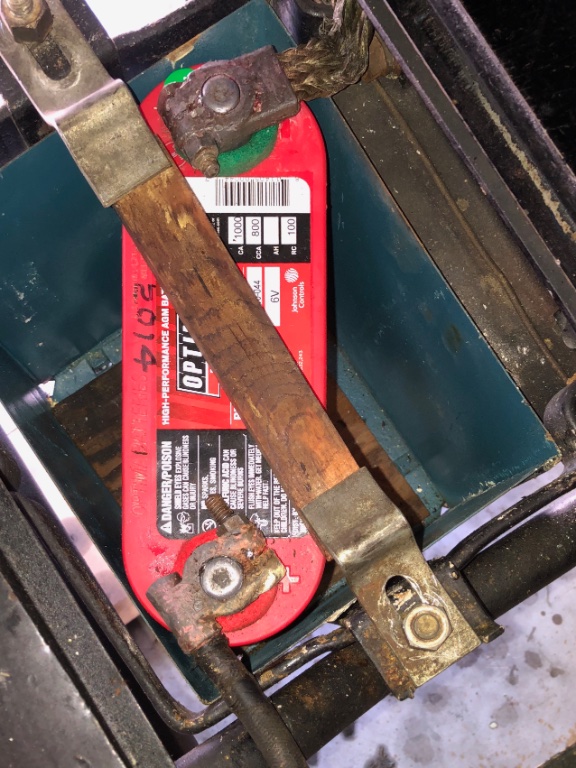

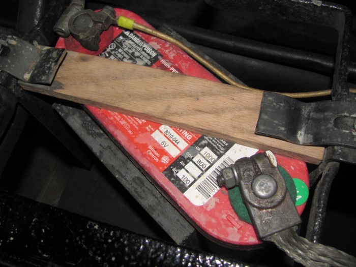

6 volt Optima red top, 800 cold crank amps, never any maintenance, as no water needed.
Smaller and much lighter than any lead/acid battery. Lasts years and years.
Just make a simple side board box, or wood base, to hold the narrow battery upright.
optima braket.jpg (67.27 KiB) Viewed 4177 times
Will fit into repro battery box if you want to hide it, this one still going strong, 2014 purchase date, today it's giving great service.

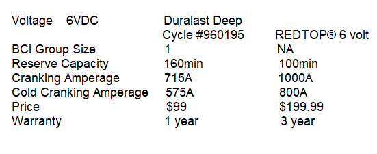

The battery size, except for Optima, is a Group 1
Specifications:
Cold cranking amps relates to how much power the battery is capable of delivering in relatively-short bursts. Important for cold weather starting
Reserve capacity relates to how a battery can deliver energy over an extended period of time. For example, if the charging system fails, the battery will power your headlights, windshield wipers, electric pumps and other electric accessories that are needed for a specified time.
Deep Cycle batteries are constructed using thicker battery plates and a denser active material, to withstand repeated charge and discharge cycles. A most for golf carts and boats.
now made in Mexico.
Optima RedTop 6 volt now made in Mexico.
The Red Top series is purpose built for powerful cold starting in applications without heavy running electronic accessory needs — usually the best choice of the three for stock replacement in applications where extra durability and long life are key. These are especially helpful in cold climates and for diesels for Optima’s highest initial cranking power to be able to start reliably every time.
Optima YellowTop: no 6 volt
Optima BlueTop: no 6 volt
