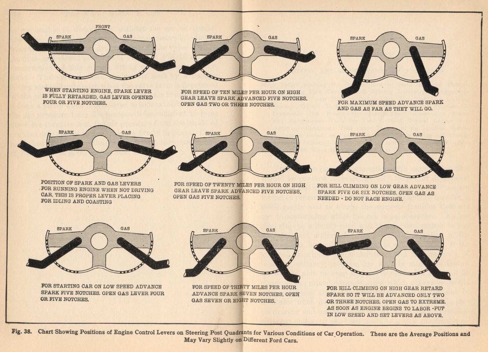

Some say these diagrams are not accurate, but they work for me and Ford saw fit to publish them in the day when, back then, the lever to lever configuration was just as confusing. If anything, it can be used as a visual reference to see how the levers relate to one another by using the description of what each configuration does. Of course each car is different so the configurations might not be exact for your car, but you can use this to determine what the general range of the configurations are best for your car to do what you need the car to do. Jim Patrick

Thanks Jim..Good visual..Tommyjiminbartow wrote: ↑Sat May 08, 2021 11:45 amSome say these diagrams are not accurate, but they work for me and Ford saw fit to publish them in the day when, back then, the lever to lever configuration was just as confusing. If anything, it can be used as a visual reference to see how the levers relate to one another by using the description of what each configuration does. Of course each car is different so the configurations might not be exact for your car, but you can use this to determine what the general range of the configurations are best for your car to do what you need the car to do. Jim Patrick

I have reviewed the above posts and did not see anything that refers to exactly what the spark lever does. To new drivers who are unsure as to what the spark lever does, it is simple. The spark lever controls the timing. Just like on a pre-computer car where you adjusted the timing by twisting the distributor cap, the spark lever does the same thing by twisting the commutator (timer) back and forth to adjust the timing in order to obtain the most efficient operation for the conditions (hills, traffic, cruising speed) and speed you are going. Jim Patrick

I don't notice a lot of change in the engine with the position of the spark lever except it does run better in about the middle position than all the way up (retarded for starting.) Follow the general guidelines in the chart, especially remembering to retard the spark when climbing hills where the engine starts to lug a bit. You'll notice that for most driving condition the position of the spark lever mimics the position of the throttle. If you have a good ear, maybe you can fine adjust the timing and get a little more performance but don't obsess over it.
