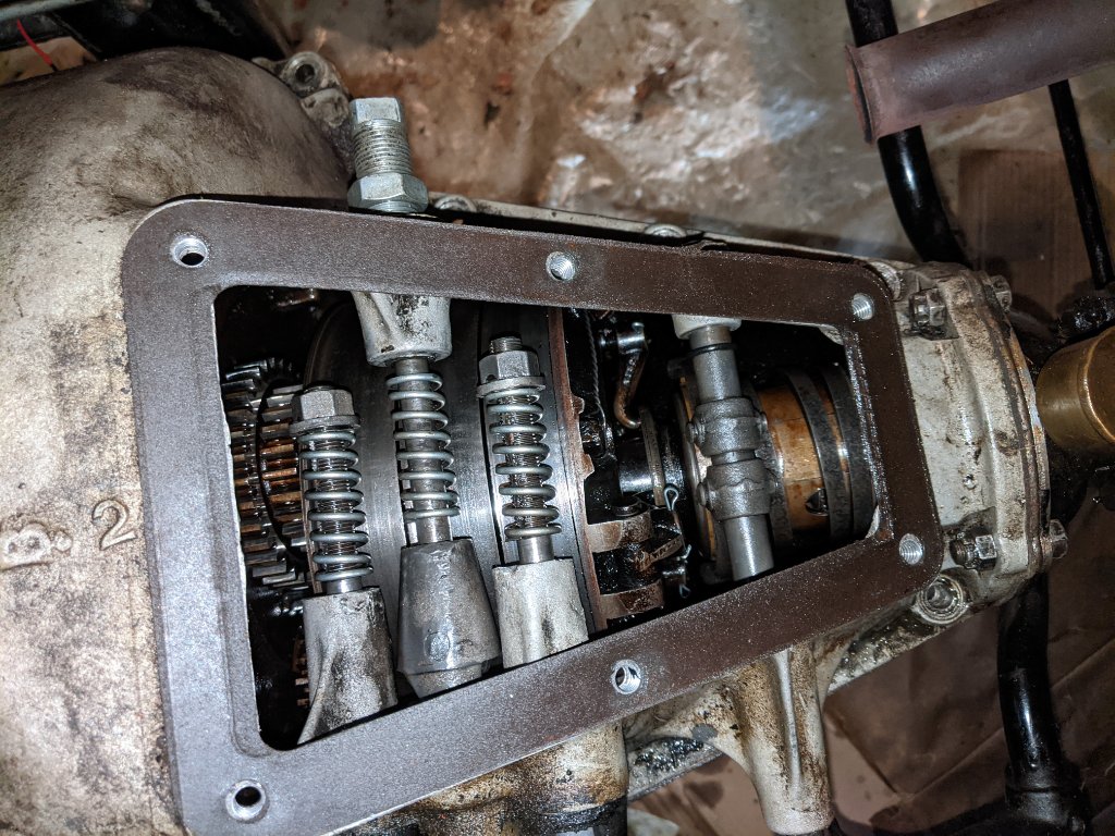

Last fall I started the T (1914 Touring, stock, no starter except me) and after idling a minute it sounded like something came loose in the transmission. It sounded like when you put playing cards on your bike to flap on the spokes. I shut it down and could hear some sort of mild abrading when I turned it over on the crank. So I took off the hogshead, took out the bands and the noise was gone. So I put the band backs and the noise was still gone hand cranking. Put the hogshead back on and the noise was still gone hand cranking. When I started the car the noise was back - cards on spokes when it was running. Back to the mild abrading when hand cranking.
So I took all the bolts off the hogshead again and loosened it up but didn't remove it. There was maybe a quarter inch gap at the front of the cover. For giggles I gave the crank a spin and the mild abrading noise was gone on hand cranking. Cinched the hogshead down again and the mild abrading noise was back on hand cranking.

I took the bands out and clamped down the cover and there is no rubbing. So it is related to having the bands in the car? They look to be cotton and are 40 years or so in the car at this point but don't look worn out. Since I have everything out I'm going to reline the bands (kevlar - good for another 40 years for sure) and reinstall to see where that takes me. The detachable ears on the bands were on the passenger side of the car which I understand is incorrect. Don't know if that could lead to a problem.
I assume I'm correct that even though my bands have detachable ears that does me no good since I have the long low speed peal shaft and the wrong low speed adjustment screw. I have the one without the pointy bit. Looks like the low speed shaft disappears into the adjusting screw.

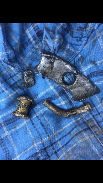

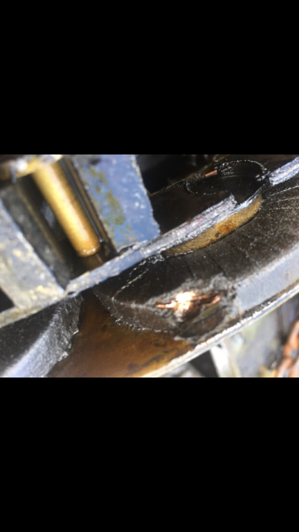

Mine had those symptoms about 3 years ago. The noise, sometimes would run on mag then sometimes it wouldn’t. I kept thinking it was the mag post shorting out but never found anything there, then the noise got worse and it wouldn’t run on mag. I guess this screw has been coming loose and finally broke. The noise I couldn’t exactly pinpoint, it sounded sometimes like the fan hitting the radiator. It was right after I removed the fan belt and the noise persisted that it finally broke.

Corey, I was looking for something like you show. I felt all the screw heads, looked at the peenings on the flywheel and tried wiggling things but found nothing that seemed out of sorts.

So after a lot of taking the transmission cover off and putting it back on I established that the noise was not present with the bands out. I relined the bands, reinstalled everything and the noises are gone. I can only assume that even though it wasn't apparent, the old linings had worn badly enough that the metal band was rubbing on something. Now it is taking forever to adjust the bands because I am scared of overtightening the new kevlar bands.
