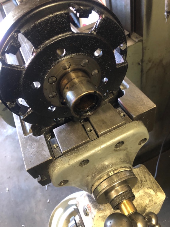

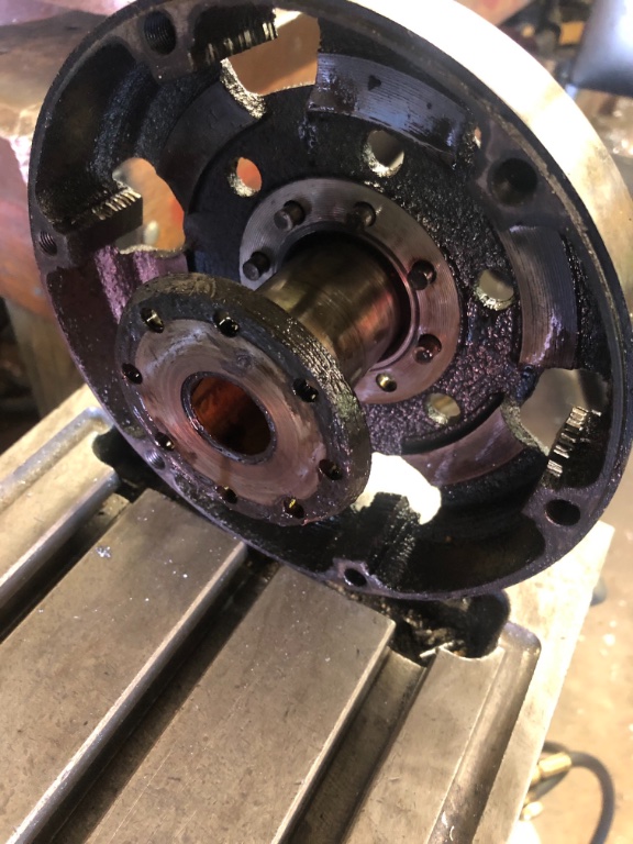

It amazes me just how much punishment Henry's Model T can take and still ran.
I have seen a lot of loose rivets over the years when dealing with transmissions. All or some loose but never seen this before.
This had to happen over a period time, but yet kept on running. I slipped the shaft forward just for the picture.

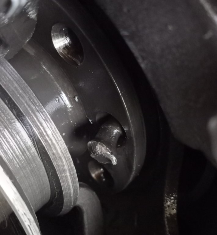

Not in my case!! :lol: Ironic for this post, cause earlier this week I posted this pic for the same reason. Pic shows the only rivet left...poor thing tried, but just couldn't do it!! Sadly my Fordor was left dead on the road!

That doesnt happen on its own. Thats the result of serious pan misalignment and/or transmission main shaft not running true. How many guys know to check the drive plate output shaft after assembling their transmission to the motor? Trust but verify.
