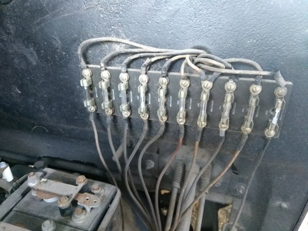

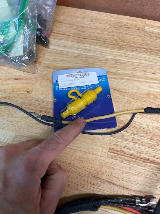

So is this where the fuze goes? Yellow wire that comes from the battery side of the starter switch. Also can I go to my local hardware store and get rubber washers for each contact of the starter switch? Looks like there are two rubber washers for each stud.

Easier access Robert is where it comes to at the terminal block.

John Regan recommends the fuse goes close to the starter switch. Mine is inside the hood, closer to the terminal block like Hank states. I like the easier access there, and it keeps it out of any water or other debris under the car. Your choice.

I install My fuse at the firewall terminal block. like Henry K and Dhort did. another advantage is being able to easily disconnect electrical power to the car when You are working on the electrical system without doing the LIMBO Rock. " How low can U go"
If You want to fully fuse all the circuits on a model T. this is one way to do it. Not needed .but then looking at modern cars with fifty ? fuses. maybe they were on to something. They take no chances and fuse every electrical circuit in the car.

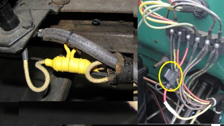

Mine is under the car close to the starter switch as recommended by John. Jim Patrick

Both Jim & Franks suggestion are a good idea. I've also always said the fuse needs to be right at the starter switch, that way you have max protection. Its easier to install of course than a separate shut-off may be, since I'm basically lazy if I had to it'd be an inline fuse. Luckily my cars already came with them!

I do take the Neg wire off the battery of all my old cars when I'm not with them. Even at car shows. I like the idea of putting it close to the starter switch as possible. I'm still young enough to get under the car if there is a problem. I'm replacing all the wiring in the car and making everything "Bright and tight" as someone said in the forum.
