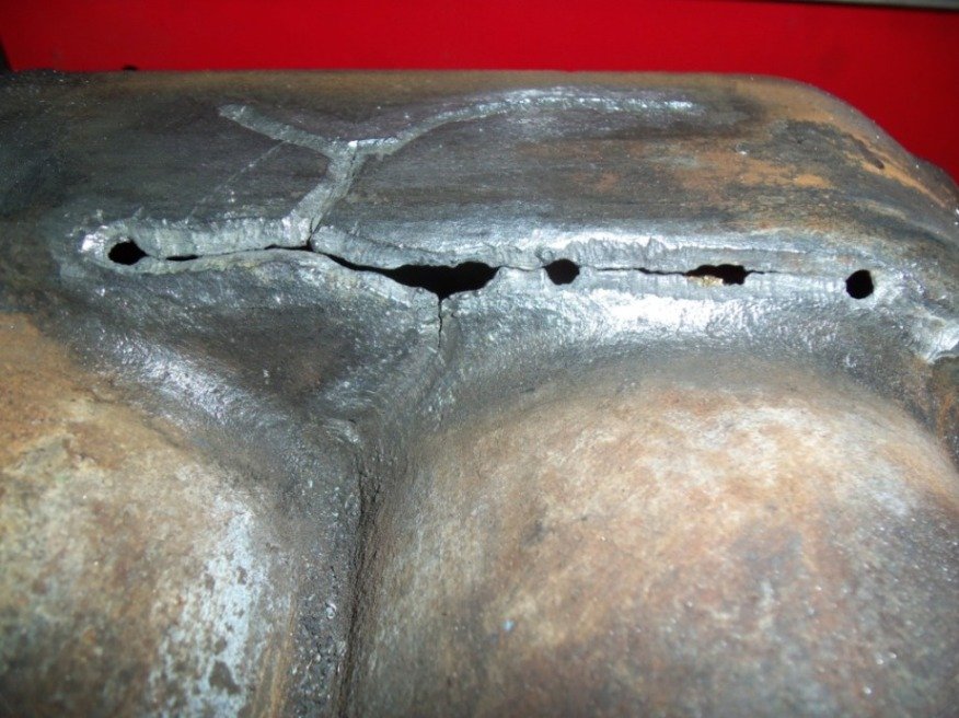

Here's a nifty water jacket crack - it had been soldered then slathered up with JB Weld - owner couldn't figure out why it "weeped" coolant !!! Not sure Lok-n- Stitch would repair this one !

Post by Dan Hatch » Thu Oct 28, 2021 7:46 pm
You would be surprised. Question is would it be worth it.
Depends on year of block. Dan
Posts: 5602
Re: Question about pinning a block
Post by RajoRacer » Thu Oct 28, 2021 8:03 pm
It was a '26- '27 block with a Fronty on it ! It has a replacement block in it now.
