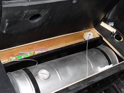

I heated the plastic with a hair dryer. And I installed the reservoir under the seat, in the compartment my car has behind the gas tank. It did make it a little more challenging bleeding the brakes in this location, but I liked it that it was less obtrusive, than mounted to the firewall.
