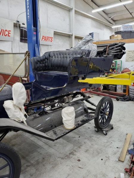

I finally found a way to raise the body so we could remove the gas tank for cleaning...I asked my son Bailey to see what he could figure out!
We have a new fuel tank, but it has some minor rust on the inside near where the baffle(s) were welded.
I'm asking for your thoughts how to best deal with this; beads, beads with diesel fuel, Muriatic Acid, Acetone, or any mixture of these.
Also, any thoughts on how to shake the gas tank if we use just beads?
Any input is appreciated.
