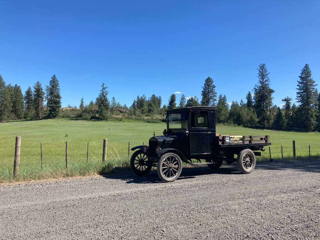

I have toyed with the idea of building a long distance TT runner, based around
a 22r drivetrain, but I always hit a wall over the character issue when I want to
add matching brakes, versus those wheels that I refuse to modify, because they
ARE the most essential character part of a TT to me. Ten years of much idle thought
on how to make it work still has me just enjoying my very stock appearing TT that
only goes 45. BTW - 45 feels like 90 in a TT.
