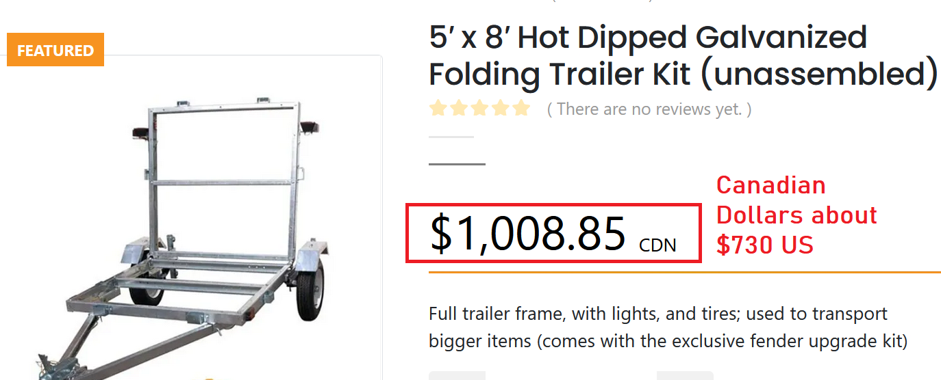

Makes me think of the trailer I built in a couple of evenings to haul home my first model T in 1974. Towed it about 1200 miles round trip with my 1974 Volvo (company car)!! The trailer was even lighter I think. Eventually sold the trailer and I kind of regret it. I still have the 27 T roadster though. LOTS of miles on it. Same engine and since 1978. Pulled some shims twice!

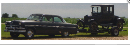

That trailer in the picture looks kind of 'dainty' to haul a longbed pickup on, it may work fine at TT speeds but i wouldn't haul it at highway speeds behind a van...

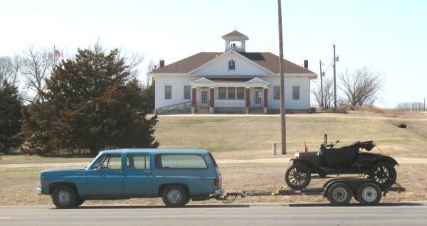

I'd be nervous as a cat hauling a car (T or otherwise) at highway speeds on a trailer like the one in your OP.
I was a little kid, riding with my dad (around 1974) in his 1970 Chevy pickup, hauling a single axle open-top (with a canvas cover) horse trailer with two horses in it. The trailer blew a tire, the trailer spun the whole rig around, the truck and trailer rolled over. We were both relatively unhurt and the horses were wearing their saddles....which saved them. The saddles were skinned up, but the horses were pretty much unhurt.
I bought John Mays' aluminum trailer. It's 16'.....which makes it just barely able to haul a moderately sized 1950's era car (with some of the car hanging off the back) and the perfect size for a Model T.
When he told me he was selling all his old car stuff, I immediately let him know I was interested in the trailer.
So...my advice is to buy an aluminum trailer. They weigh A LOT less than a steel version and the fact that they're aluminum makes the detachable bits, like the fenders and ramps, much easier to move around.
As a side note: I'd love to have an enclosed trailer, but 1) I really like this trailer and 2) I'm cheap. So...my plan is to tig-weld a removeable aluminum frame for this trailer that I can make a custom-fitted cover for.....making it look sort of like a low-slung conestoga wagon.

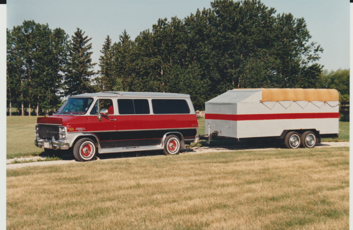

Don
I had a converted 3/4 ton ‘80’s Ford truck with a “beaver tailed” flatbed. Ultimately made 5 removable bows from ridgid conduit and had a fitted tarp sewn up. The tarp was held on with straps and had zippers on both sides of the back.
The bows fitted into sockets. I could erect it in 10-15 minutes. A bit of the best of both worlds!!

That sounds ideal. Do you have any photos of it?Les Schubert wrote: ↑Thu May 13, 2021 2:28 pmDon

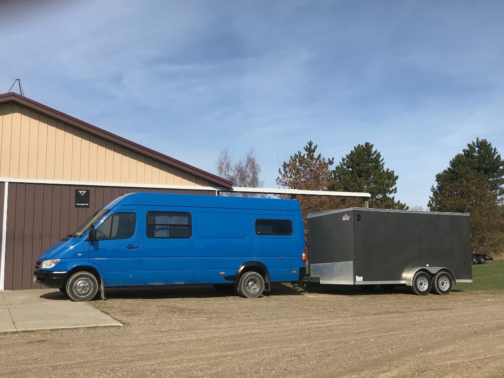

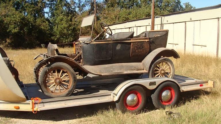

Trade the van in on a 4-door pickup (NOT a "super cab" type), get a DUAL axle open trailer with at least 15" wheels and you'll be happy and safe. Not knowing the reason for owning a van, I can only assume a 4-door pickup will not only haul what you need comfortably and safely, but also provide the interior space you need in your vehicle.
Here's what I tow my 8.5'x 20' trailer which is tall enough to keep the touring top up. Great investment.

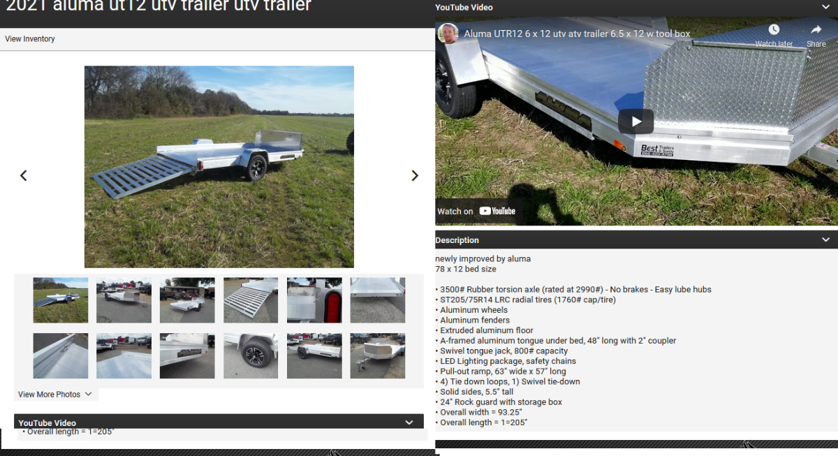

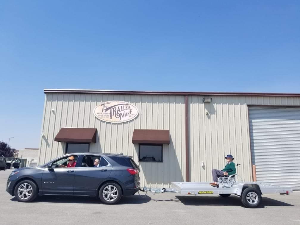

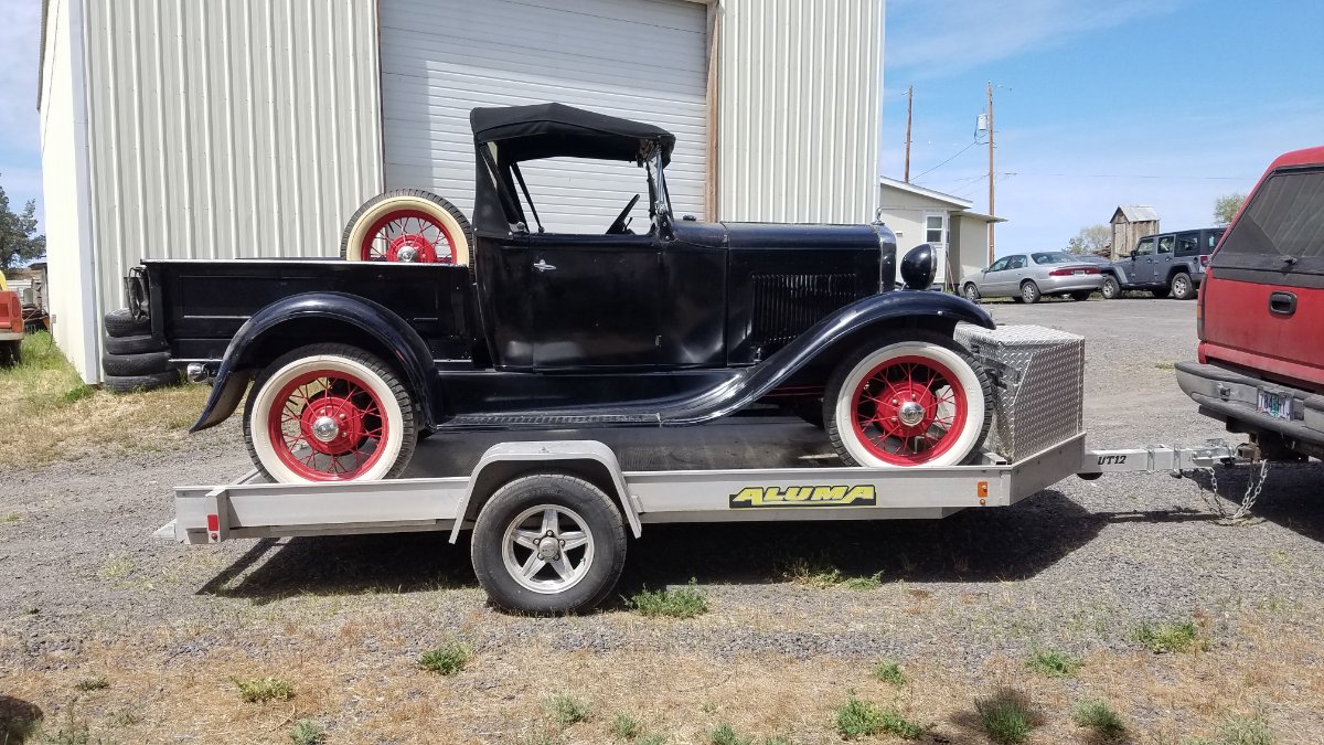

Ignacio,
Check out the Aluma, 7712 Heavy Duty Utility Trailer. 750 lbs. My T is another 1,500 pounds. My Chevy Equinox tows 3,500 lbs. The trailer has just enough bed space for a Pick-up style utility box to be mounted up front to keep all my trailer straps, blocks, chains, etc. It has served me very well.
Ignacio,

I have a 14 foot (16 feet with the angled nose) 7 foot wide enclosed trailer that I haul my '17 Touring in. It weighs 2172 lbs empty. I don't know what your T weighs but if you go with 1300 lbs that adds up to 3472 lbs. It has tandem axles, 15 inch wheels and electric brakes. I've hauled it thousands of miles with no issues.
My opinions:
1.) You don't want a trailer that has the minimum weight rating to haul your Model T.
2.) It should be long enough that you can position your T to properly load the tongue.
3.) I believe in tandem axles - tires can fail for lots of reasons and losing a tire on a single axle, heavily loaded trailer can be catastrophic.
4.) I hate small tires on a trailer. If you're going 70, they're going over a hundred. Anytime I've driven north on I-75 I've passed a few trailers on the side of the road with either shredded tires or destroyed bearings.
5.) Your ability to stop and control a trailer is often determined to a great extent by the weight of the vehicle towing. My 8000 lb van has no trouble stopping a trailer like mine, with or without trailer brakes. If your tow vehicle weighs 3500 lbs then stopping a no-brake 3500 lb trailer would a little more difficult.
6.) Speaking of a 3500 lb towing capacity - If you go a little over it isn't a big deal as long as the hitch is capable and the tow vehicle not too lightweight. Just don't get crazy.
7.) Before I bought my enclosed trailer I was looking at a tandem axle open trailer made of aluminum. I was planning on using it to haul my 1952 Army Jeep (2500 lbs.) It would replace an old steel tandem flatbed that was showing it's age. When I bought the T I decided instead to find an enclosed trailer because of my concern that exposing a T to the wind at freeway speeds could be damaging. A lot of guys use open trailers with no problems but I felt better going enclosed. One of my concerns was if I was traveling a great distance and staying at motels that having the Model T under lock and key was better than leaving it exposed to possible theft or vandalism while I slept.
You've gotten lots of opinions on this thread...sort thru them and make your choice. Good luck!

I built the trailer in the original post. It tows fine. It has a modern axle with electric brakes. I have three sets of tires/wheels in different styles depending on which tow vehicle I use.
- Attachments
- IMG_20210515_103046_edit.png (135.29 KiB) Viewed 16608 times

This is the trailer we built it will haul any car we have the top is plywood and steel tubing for wire with a canvas top pulled by an 83 chev van

A friend just sent me a picture of his new trailer, it looks like a nice light aluminum trailer.
- Posts: 7278
Re: Lightweight Model T Hauling Trailer?
Dennis, I like your friend's new trailer. If he can winch/drive up to the toolbox, the tie downs are at a nice steep angle and there is no "pull" on the axle, as the car meets the toolbox. If he can easily slide the axle front and aft to adjust for varying loads, he has it nailed.

While I wouldn't recommend building a car trailer like this today, my frist trailer was a 20 year old used single axle, no springs or trailer brakes. The trailer was built in the late 1950's to haul a Ford flat head V8 dune buggy. After new tires, rewiring the lights, checking and repacking the wheel bearings it was frist used to haul a Model T Speedster. Over the next 25 years that trailer would haul various Ford Model T's and Model A's. It would make several trips from Fresno Ca and Fullerton Ca to northern Oregon and a trip to southern New Mexico to bring back a Model A. The key in all the miles was to always check the tires for condition and pressure, replace when needed, plus keep the towing speed below 60 mph even in States where higher towing speed was legal. I sold a Model T with that trailer to a new club member who needed a trailer and know that it continued in use for atleast another five years.

It is an Aluma UTR12. It looks fabulous. The ramp rolls into the underside of the trailer. Retail new looks like nearly $4K.

The HF trailer platform width is spec'd at 48 inches. the Model T wheel base, depends of tire size, is about 60 inchesivaldes1 wrote: ↑Wed May 12, 2021 11:28 pmI am intrigued by this purpose built trailer http://www.mtfca.com/discus/messages/50 ... 1223858517 that looks like it was built specifically to haul a Model T. Are there plans available to build something like this? My van can only do 3500 lbs towing capacity so a hefty car hauling trailer is out. The one in the picture looks lightweight.
Or can these/have these been made into a T hauler? https://www.harborfreight.com/1720-lb-c ... 62647.html
Here's a possibility (for sale in Canada) https://diyfoldingtrailers.com/product- ... /trailers/
Weight of Trailer 243 lbs
Maximum Working Load 1737 lbs
ivaldes1
Topic author - Posts: 960
- Joined: Mon Jan 07, 2019 1:32 am
- First Name: Ignacio
- Last Name: Valdes
- Location: Houston, Tx
This might be a possibility. I put some calculations into Chatgpt to calculate the position needed for a normal tongue weight. It said that even with the car loaded in reverse position and with 2 foot extensions off the back for the front wheels to shift the car backward some that the tongue weight would be unacceptably high (10-15% of the overall load). The trailer axle does not appear to be able to reposition, so it doesn't seem to work with this trailer configuration due to excessive tongue weight?
TRDxB2 wrote: ↑Wed May 29, 2024 12:09 pmThe HF trailer platform width is spec'd at 48 inches. the Model T wheel base, depends of tire size, is about 60 inchesivaldes1 wrote: ↑Wed May 12, 2021 11:28 pmI am intrigued by this purpose built trailer http://www.mtfca.com/discus/messages/50 ... 1223858517 that looks like it was built specifically to haul a Model T. Are there plans available to build something like this? My van can only do 3500 lbs towing capacity so a hefty car hauling trailer is out. The one in the picture looks lightweight.

I bought this 7’x12” Aluma maintenance trailer with heavy duty ramp to get my dad to tours on the west coast. (When it’s not raining) Weighs 750 lbs. Carries 3,500 lbs.
Later, I built a cover out of 3x3 pine and 1/4” plywood just big enough to cover my 1915 Ford Touring. I call it “The Hillbilly Trailer”. 10,000 miles later, it has worked out really well.
