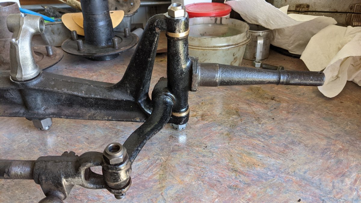

The tie rod bushings of my spindle arms are not parallel with my spindle bolts. They are tipped upward a little. I loosened my spindle arms while I rebuild the axle assembly. I reinstalled the tie rod with arms loose. When I turn the spindles from side to side the tie rod binds on the arms but only at the extremes . They don't bind at the middle straight ahead position. When I test it with one tie rod end disconnected, the free tie rod end goes up and down as I turn the spindles. That means the arm bushings are tipped forward at the top relative to the spindle bolts. How can I straighten them? Heat? Press? Other ideas? I have neither a torch or press.

Are you sure you have them on the correct side and the bend turned correctly. Its easy to get things turned around
Pictures of your set-up would also help others understand the situation & resolve.

I'll take photos today. They are the same as I disassembled them.

I think I have them on correctly. My part numbers don't match the axle book. I have T282B on the right and T270B on the left.
