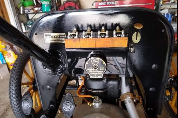

I am working on my '15 runabout (COVID 19 project) and am looking for drawings or a schematic of the firewall to assist in general fitment, the right location for placement of all the various holes and since I have installed a starter on my '15 engine the right shape and size of the modification to the bottom opening for clearance. Trying to avoid trial and error !!

The Benson Ford Research Center at the Henry Ford museum in Dearborn has factory firewall drawings. You'd have to talk to someone who is familiar with the procedure for procurement in order to obtain the appropriate drawing for your car.
Note that the firewalls from the vendors are generic. For his 1917 touring, my father had to make a number of corrections using the factory drawing and an original firewalls as a reference. See my second post in this thread:

Check out cimorellis.com Model T Ford digital library.
There is a section for wood body plans plans for Model T Ford. There is a firewall drawing along with plans for different parts of T bodies. It not totally complete but it is some good information for those who need it.
Lang’s also sells wood firewalls for T’s that had them. They are pretty well made. You probably already know this.

Lang's and the other vendors do sell wooden firewalls but they are not correct as I posted above. They work, but they are not correct.

I got a 15 firewall from Snyders in early 2019 when I was restoring our 15 runabout. I was very happy with the quality and fit. I did have to sand a slight taper on the edge to fit more easily into the cowl piece, but that wasn't a big deal.Erik Johnson wrote: ↑Fri May 14, 2021 10:26 amLang's and the other vendors do sell wooden firewalls but they are not correct as I posted above. They work, but they are not correct.

The one I bought for my 1919 Roadster years ago worked fine for me. Seems like I redrilled a hole for some reason but I didn’t lose sleep over it.
The original wood firewall was long gone and I was happy with the one I bought.

I don't believe you need to modify the firewall for a starter. I put a starter engine in my `15 T. Original firewall. Didn't need to modify anything. Engine also had `26/`27 pedals. It fits! I would have never thought so either!Hardie wrote: ↑Fri May 14, 2021 7:16 amGreetings from Canada. Wishing everyone good health and safety in these interesting times as our early "T's" are make their way through their second world-wide pandemic.

It appears I'm now off to the races and am generally sure I won't be sacrificing a perfectly good piece of 3/4 inch birch plywood. Mac
