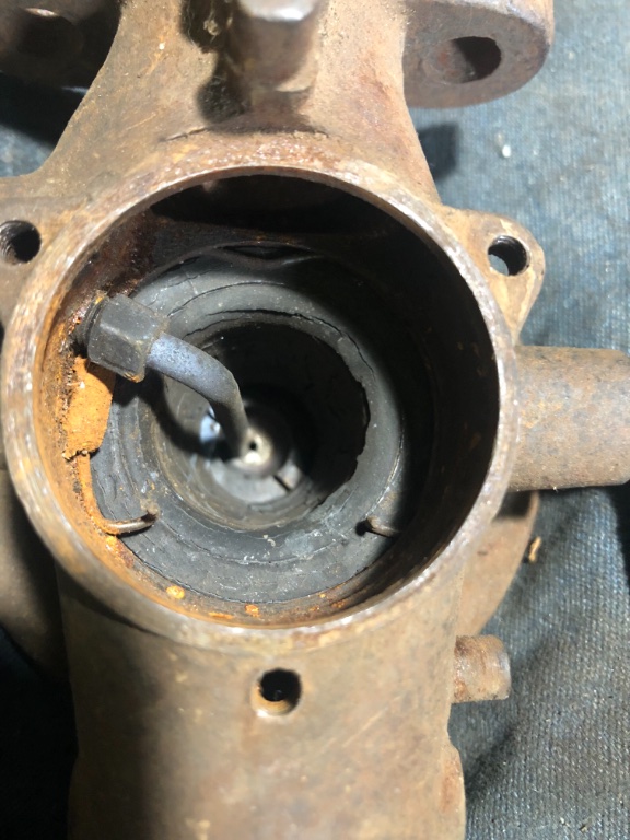

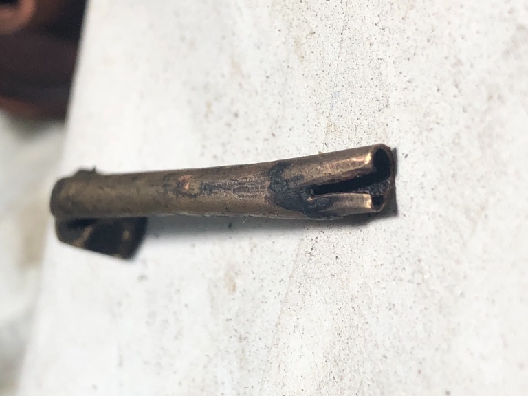

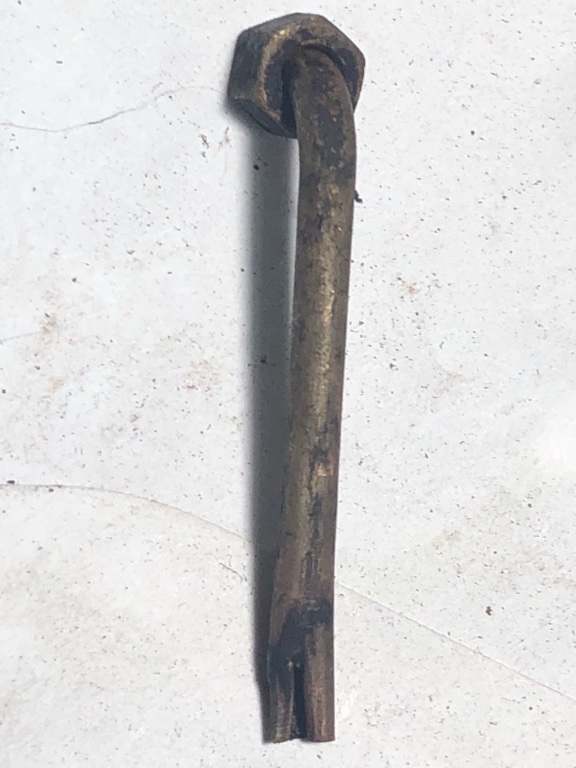

Holley G isle pickup tube too close to spray needle
Post by Corey Walker » Thu May 20, 2021 3:19 pm
A lot of times when you take something apart you can figure out why somebody quit using it. I bet they experienced hard starting and a bad idle. The spray needle wore a hole right through the tubing.

I enjoy posts like this for trouble shooting. GOOD FIND !!!
