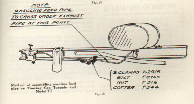

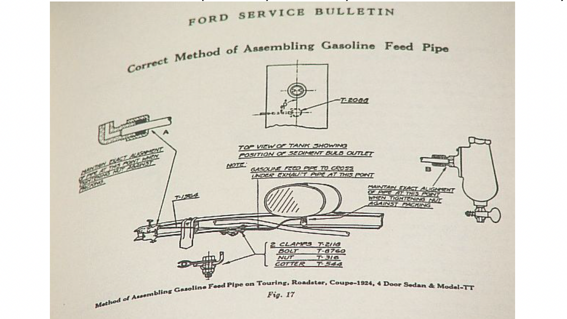

Yep,....it should be routed differently. The book sez the fuel line should be routed under the wood block that fits between the frame and right crankcase ‘ear’. Someone will have a diagram from the Service Manual.
Well, there you go; our friend Scott supplied the illustration. I didn’t notice it before

That diagram is in the link I provided

The diagram posted by JTT3 is according to the book. Most important thing is to clamp the line to the frame where it passes under the exhaust. It is OK to have a low point in the middle of the line. But there should be only one low point and the line should go uphill from that point to both ends so that any air or vapor bubbles which could be in the line will rise to either the tank or the carburetor. otherwise if there is a high point in between the two ends the bubble will stay at the high point causing "vapor lock".
