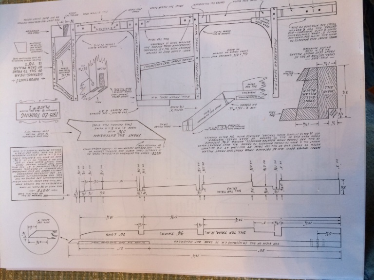

I noticed the posting about model T wood plans.
So I have a set of 15-20 touring wood plans by
“M Miller” dated 1969!! I have used these plans over the years and have been very satisfied!!
I am contemplating having them “digitized” and making them available.
I m not sure if I will get in trouble, but considering the copyright is over 50 years old and I’m a Canadian, who knows!!
Considering that most of the details didn’t change much from 20-25, I’ve found them very useful.

I have a set of 14 wood plans, I will have to dig them out and see exactly what I have.

Dropped them off for scanning this morning. Should have them tomorrow.

That's really nifty!
Now, if someone can come up with some for a 15-23 roadster...

Roadster; so the front half of the touring will do nicely. I am considering making drawings of the sills I have made for my roadster project (I had half decent examples)!

Please do Les and include them with your plans. Best John

If that's the case, count me in, Les.
Hopefully can source some local wood to make the wood body supports and a bed as well.

I will put it on the list!! Hopefully in the next couple of weeks
