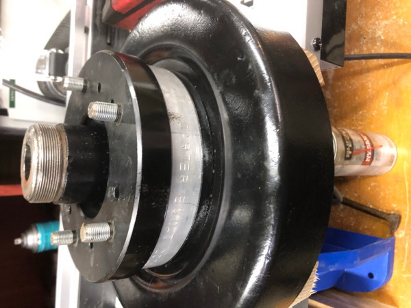

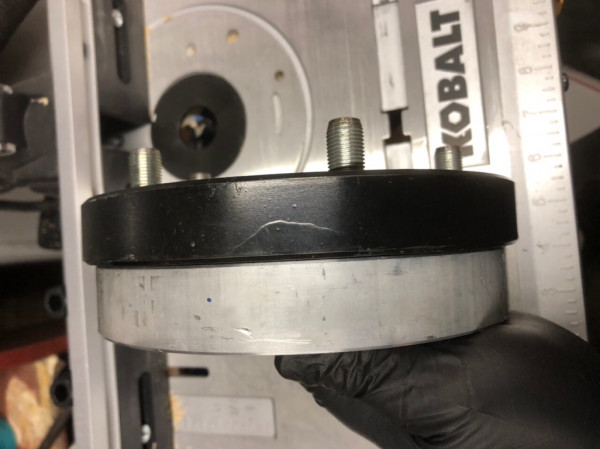

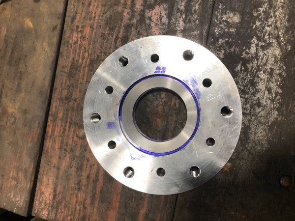

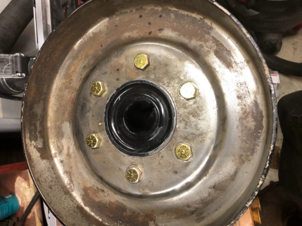

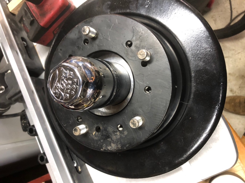

I made some adapters to run model a wire wheels. Habanero been able to run them yet but hopefully will soon.
Brad
Brad
