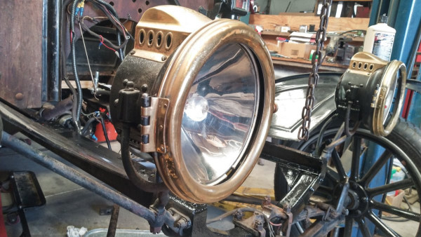

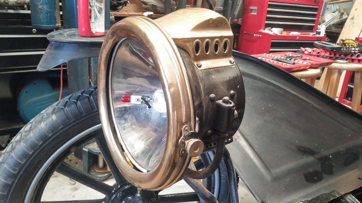

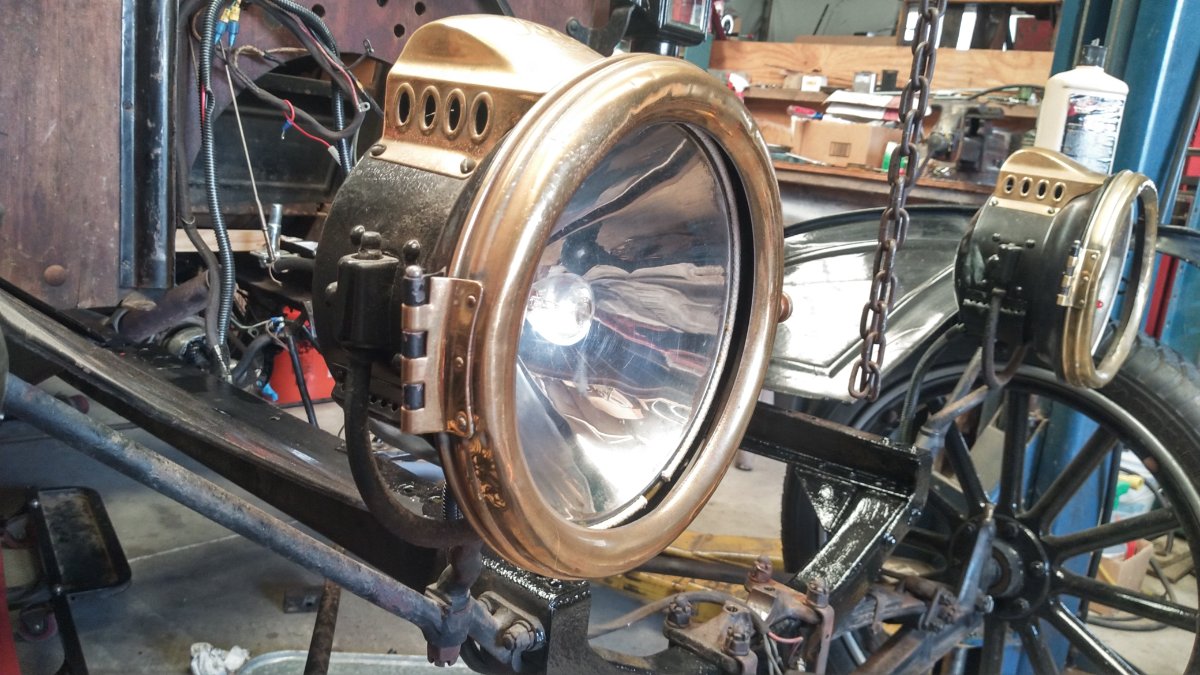

John:
I'm not schooled in Brass Lamps.. But I own a Camera..
Will these Pics help?.. The top pic I took is too big to upload.. If needed I can try to resize it.. There is writing on it but the numbers look to be two digit, embossed and polished to oblivion..
Thanks for your help..
Cap
Cap

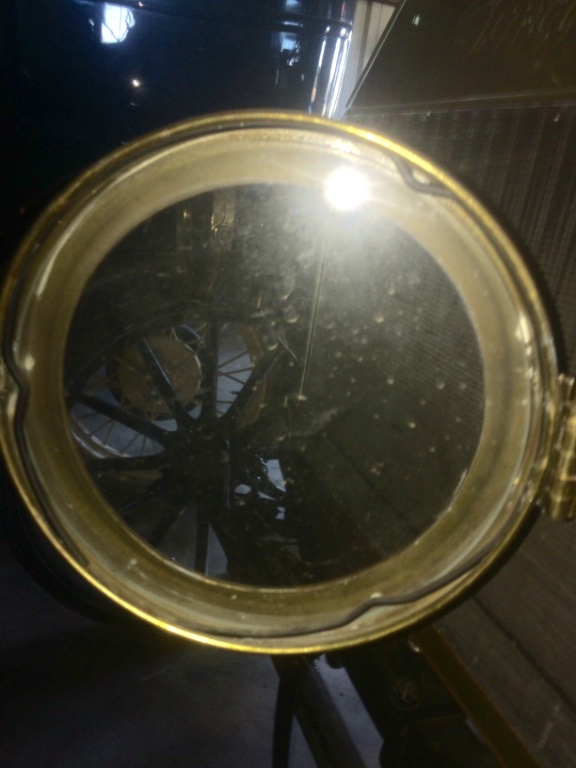

Well, they’re not E&J. I’ve opened the door on my left ‘14 headlamp to try and illustrate what I meant by large 3/32” O ring. See the 3 “dimples”

They appear to be Jon Brown model 16 so this will be easy. If you note the reflector sits nicely inside the bucket with an 1/8 in space around the circumference when centered. To do this the lamp needs to be off the forks so you can work with it. 4 ways to go here if you’re using the reflectors in it. 1- Buy a tube of 100% silicone, clean the inside surface where the reflector will sit centered with alcohol, lay down a heavy bead of silicone and nest the reflector in it, once nested run another bead on the top edge of the reflector, with a wet finger lightly smear the top layer of silicone so that it joins the bottom layer and forms, if you will, a gasket that should hold the reflector once dry, I’ve tried epoxy but it shook loose after a while your mileage may vary. 2- similar to the above but this time you will have to (3-4 places) sand to metal and silver solder the reflector in. 3- the most labor intensive, you’ll note there are 3 holes where machine screws were holding the wedge that seated the parabolic mirror. You’ll have to find 3 long thin bolts that will reach the holes you’ll need to drill into the edge of the reflector and lock down with a nut & lock washer. Looks like crap but works. There are various other ways to do this similar to number 3.

Sorry about that I thought I read that it was loose and rattling in the bucket, on the lens retainer like my good friend George expressed pretty simple to fabricate. Also George is exactly right about any decent glass shop can cut you to lens for about $20 bucks. Find some spring steel rod and bend it round using a large coffee can. In a pinch I’ve use a metal handle from a five gallon bucket and shape it to fit. Since your using bulbs instead of acetylene you can use a version of method one I explained in the post on setting the reflector. Set the glass in the door and use silicone around the edges, of course remove the door by taking out the pin in the hinge so your working with it face done. This is most definitely not a good idea if you’re using acetylene though, silicone and really high heat is bad mojo.

I found that coat hanger wire is the right size for retainer ring. Easy to bend and stays in place.
