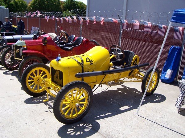

Ed Archer's #4 speedster has 5 lug Firestone wheels on it. IT should be pretty easy to dig up some pictures of Ed's car.
- Posts: 4356
Re: Firestone 5 lug accessory wheels
Ed's number 4 has Perlman wheels. I do not know just how the companies were related. I have read a few things, but cannot remember enough about the details. Perlman were related to Motor Wheel Corporation (my Paige has Motor Wheel wheels on it). Motor Wheel I think may have been somehow connected with Firestone. The wheels, and lugs, are very similar in design. I remember seeing wheels for Model Ts with a third manufacturer's name. But I cannot remember what that name was. As I recall, there was a series of mergers/divestitures between the companies right around 1919/'20. The Jaxon Wheel Company was also connected to Motor Wheel Corporation. Jaxon, best known for the steel disc wheels used on many General Motors automobiles during the '20s, made both wood spoke and steel disc wheels during the late '10s and early '20s.
