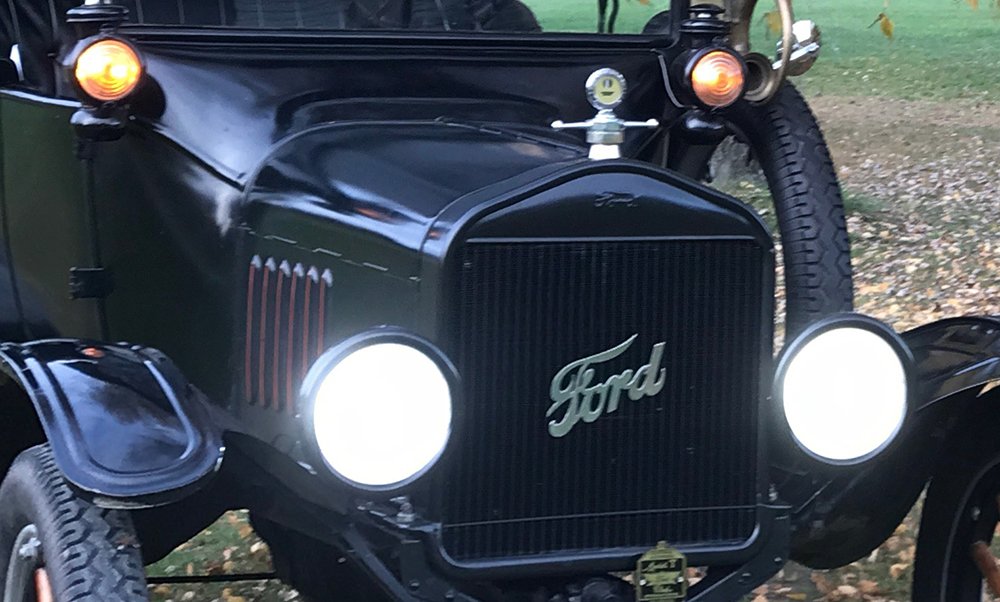

I have a new (2019) Bergs low (black) radiator. I put a motometer Jr. and winged cap on it. After 2000 miles the neck came loose and I had it soldered back on. Today, after 1200 additional miles, it appears to be coming loose again. After fixing it the first time I changed the wings to a dogbone (lighter weight) but kept the motometer.

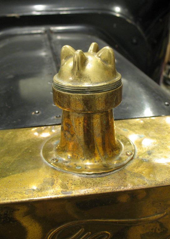

I have a Bergs radiator on my 24 Coupe and no trouble so far. I do remember that when I replaced the neck on an older flat tube radiator that was on my 21 Touring the radiator itself had a slight lip on the top tank that I slightly pushed down on the lip of the new radiator neck. Now that I think about it it did help to hold the neck down just a little.
I had bought a new neck for it at Chickasha from Bergs and the neck had a lip all around the bottom.
I don’t know for sure if an original Ford radiator had that lip on the top tank. I can’t remember.

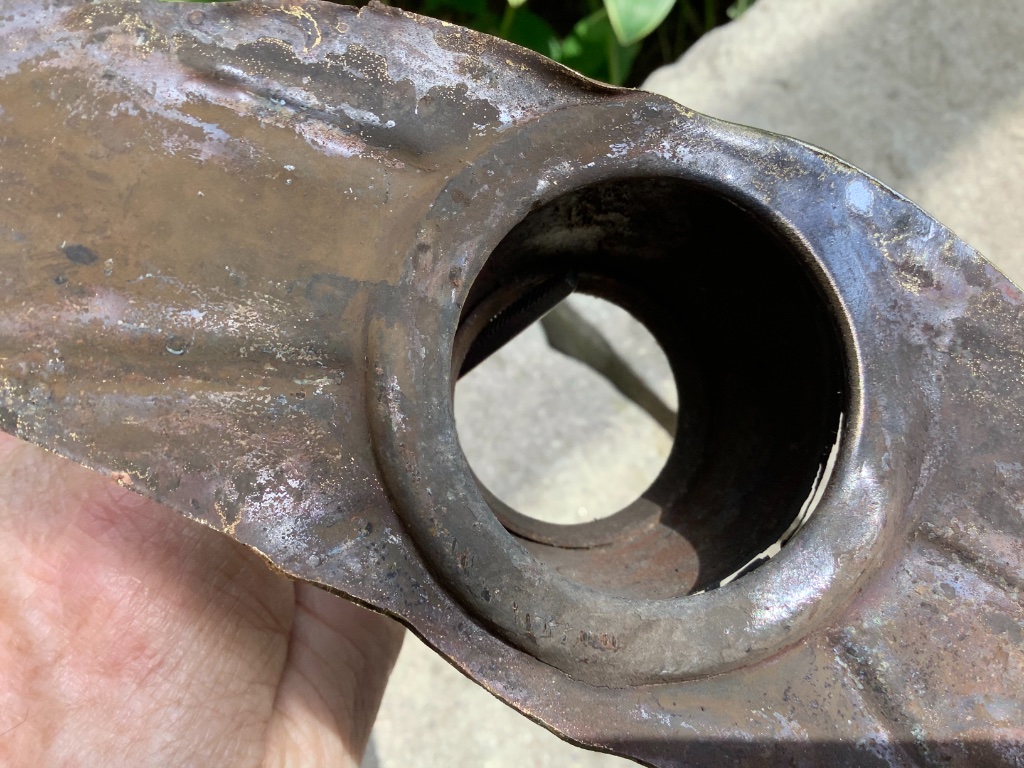

On original radiators the hole in the top plate of the tank was flared upwards. When the neck was fitted the flare was bent over a lip on the inside of the neck. Thus there was a mechanical bond as well as the solder joint. I don't think any of the reproductions have the flare on the top plate, and they rely entirely on the solder to hold the neck in place. About the only thing you can do to make it a stronger joint is to use silver solder.

If you are losing radiator necks because of ornaments, you need to find some better roads to drive on. I cannot comprehend a neck loosening up from that. A neck, at the minimum , should have a rolled edge on the bottom, to trap the top tank metal before soldering. Perhaps someone is skipping that easy step? Originals were done several ways but always had a rolled seam, not just set in place and soldered.
- Posts: 7345
Re: Berg's Radiator Neck
Plus rivets for several years.

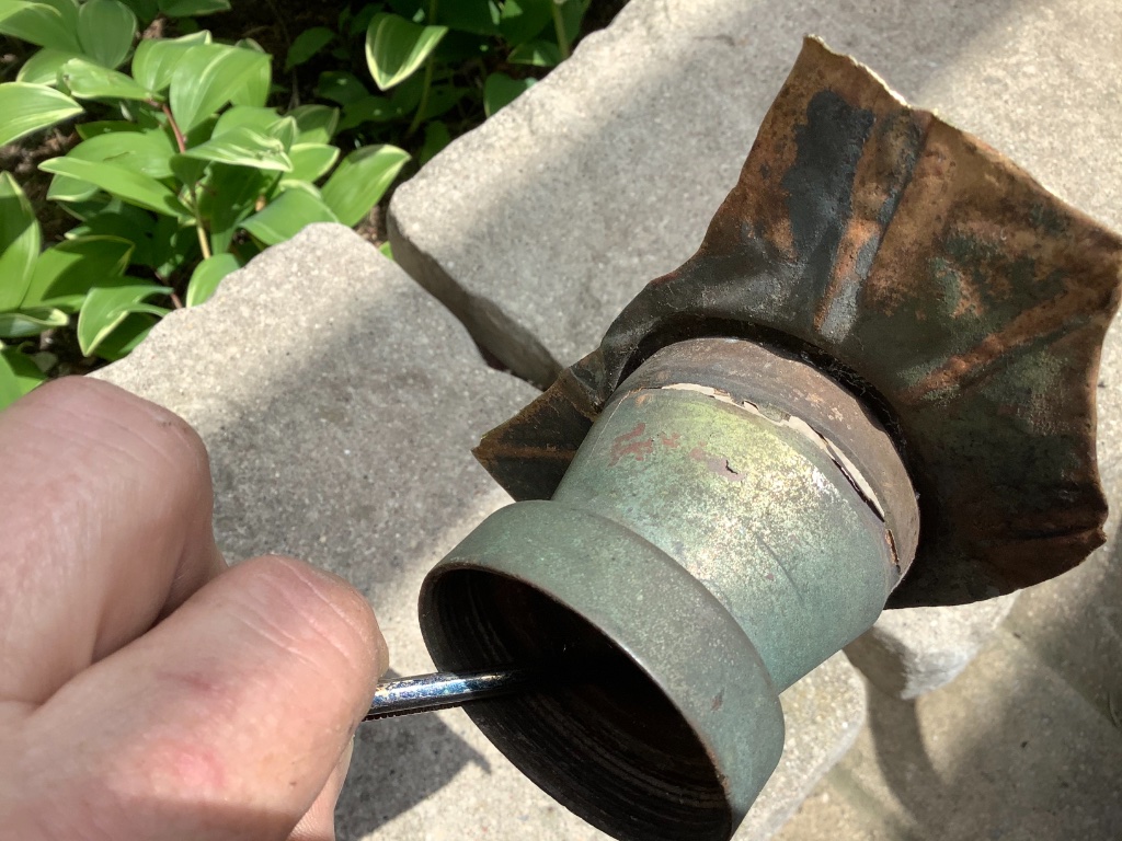

The early ones were riveted instead of rolled! I salvage a lot of necks to display ornaments on, and just did one yesterday. If the necks aren’t rolled into the top metal, OR the top metal isn’t rolled into the cap, they aren’t going to hold up. I’ve seen them both ways, I’ve also seen aftermarket rads also riveted, and rivets hidden under the steel shell.
This one has the top panel rolled into the neck, THEN soldered.
Tim, I’d think about taking it all the way off and then rolling the seam before soldering. It’s doable.

We had the same issue when we installed a larger winged moto meter on our radiator. The neck came loose and needed to be reattached. It was not easy to hold the neck to the top of the radiator and the only way I could make it work was to silver solder 3 spots around the neck for strength and fill in afterwards with regular solder to make it water tight. Has held for years and still seems strong with no leaks. Give it a try as it was not that hard but to me a good fix.

Great idea for a fix, Nick. A fix that shouldn’t hafta be. These are the simple things that make me crazy. These radiators are incredibly expensive compared to , say Model A rads. How much longer to just do it right to start with?
