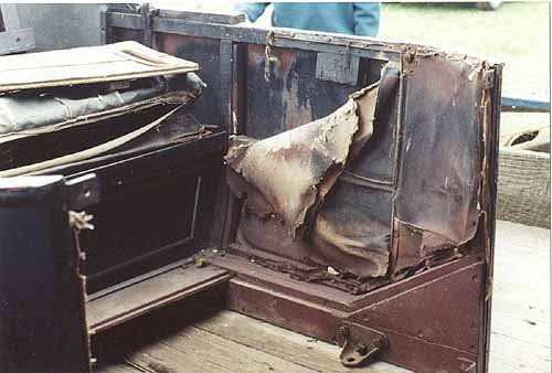

No dimensions, but here is a picture...
1914 body drivers inside.jpg (37.25 KiB) Viewed 4887 times

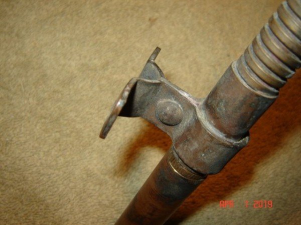

Oh, and here is the correct bulb mounting bracket:

Keiith: What year was that one used on? Mine all have the turned bracket.

I have a bracket like the one in the picture from KWTownsend, but I don't know what this turned bracket is.
Can you describe or post a picture?

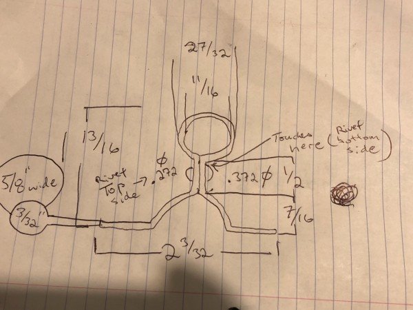

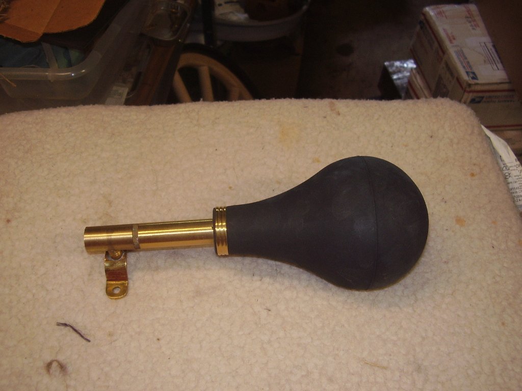

Here is the 1915 bracket. It does not stick out as far as the 1914 bracket.
1915 horn bulb bracket 3.JPG (47.62 KiB) Viewed 4438 times
Here are dimensions, thanks to Corey Walker:
1915 horn bulb bracket 7 Cory sketch.jpg (50.99 KiB) Viewed 4438 times
Any it won't break like the turned and soldered together reproduction brackets!

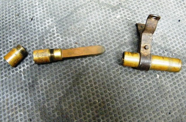

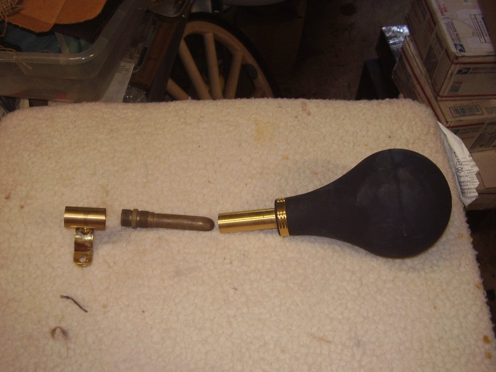

Two problems with the early 09-12 (long) repop bracket: 1. They are, as Keith pointed out, sort of swedged together and soldered, an arrangement that is easily knocked apart in actual use; 2. Not a problem with the piece per se, but a lot of guys use this bracket on the late '12-'14 cars, which should not be done because it's too long and gets in the way of the driver's knee. This usually breaks it. The long brackets are meant to be mounted on the outside of the body. The correct late '12-'14 bracket, which mounts on the inside, is much shorter. These are the ones that I make. They look original but have a threaded "spine" which runs inside the full length of the spindle and up into the tube, where the protruding end is milled off. It is then soldered in place. This makes it considerably stronger.
Exploded view: correct late '12-'14 bracket, correct reed/holder assembly, correct horn bulb:
Assembled. The reed is up inside the bulb sleeve; the brass flex tubing with the short threaded sleeve on the horn end is sweat into the other end of the bracket to make the complete assembly:
