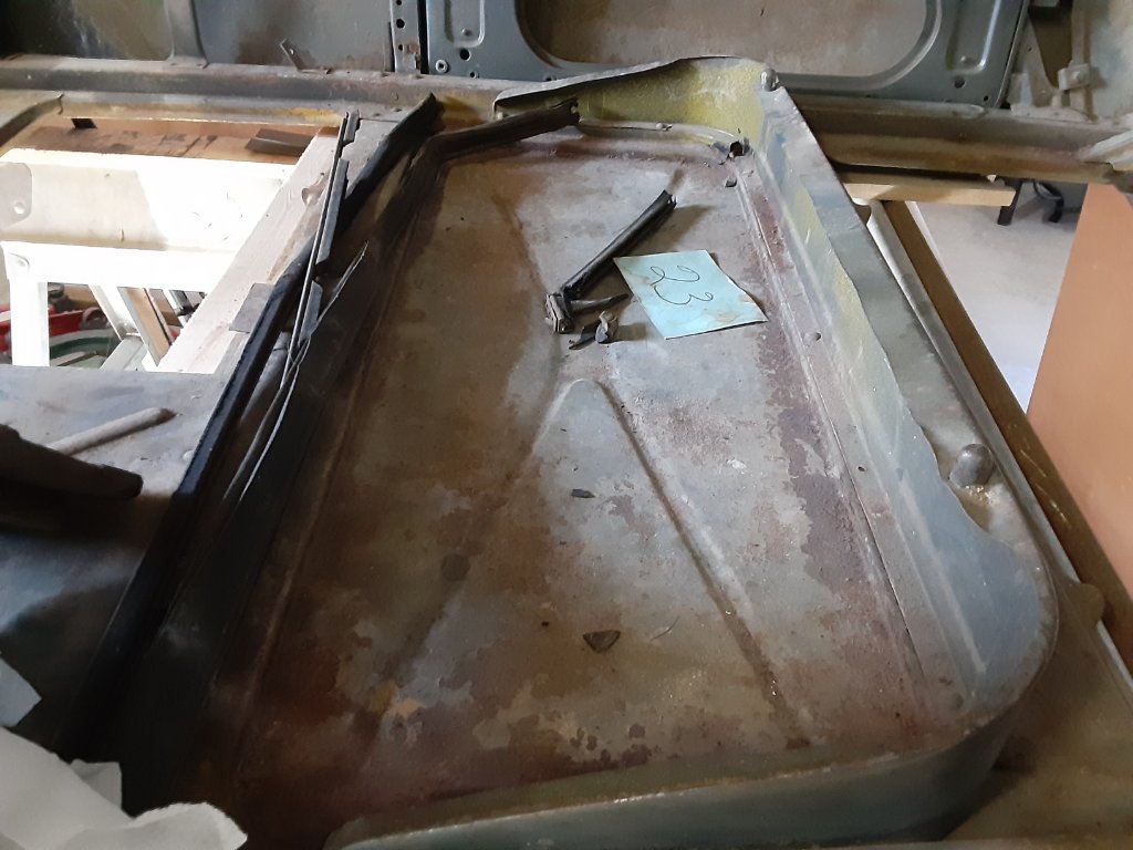

Post by BLB27 » Sun May 16, 2021 10:37 pm
The attached photo shows the floor under the seat inside my couple. It will be blasted cleaned. However, there are small seams near the front vertical part of the seat support. The blast cleaning will not remove rust in the seams. There are other small crevices at various places in the floor. I am thinking of putting some "Krud Kutter Must for Rust" in these seams and crevices and letting it soak and dry. Anybody see an problems with that procedure?

To answer your question, I would clean up all that I can, then paint with Rustoleum rusty metal primer, followed by Rustoleum flat black.

Clean by vacuuming well, on a warm day, low humidity, give multiple light coats. Done!

You could use a product called evaporust found at harbor freight Walmart and other like stores even on Amazon. I have used it with a small electric pump with a hose that sprays the liquid on the area and another hose for the pump to suck the liquid up. I used a large bucket to catch the sprayed evaporust that concentrated the liquid on the area that was rusty Worked like a charm in about 5 hours of me doing nothing but checking on the progress. I’ve also used it to clean out heads and blocks using the same technique, great product.
