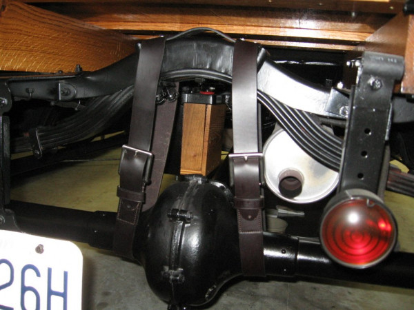

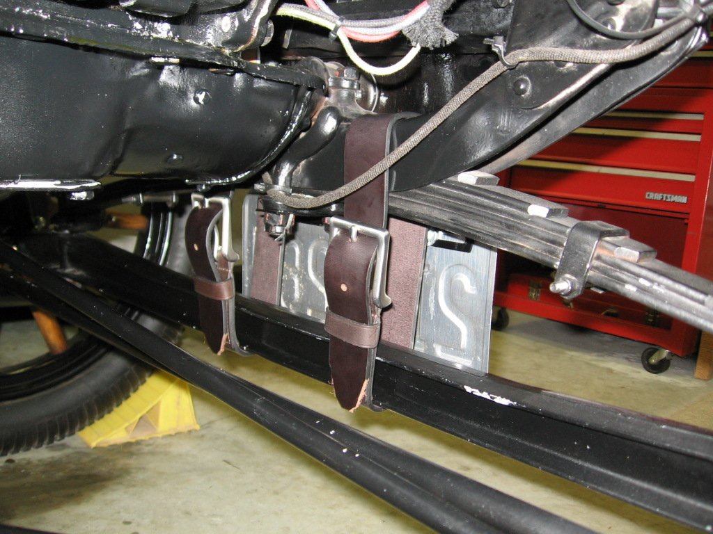

I run rebound straps on the front and rear of my 1924 and consider them a worthwhile improvement. I made them out of the heaviest leather belts I could get at Walmart.

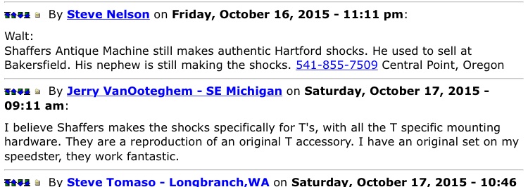

I have a feeling the OP is asking about real shocks. Yes, there are reproduction “Hartford” friction shocks available for the T’s, that cause no interference with accessory brakes or create potential chassis failure points. They simply provide resistance to the free motion of the springs.
The safety concerns stated in previous posts are relative to “Hassler” and similar design era accessory “shocks”. These “shocks” commonly have altered design spring mounts and additional helper type springs made with inferior metallurgy.

Don’t know if they’re still available, but here is a clip from an old thread;
