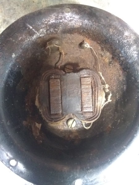

Post by TheSaintDiscJockey » Tue Mar 12, 2019 3:08 pm
The inside of my horn.
A bit confused at this point.
Pretty old and beat up.

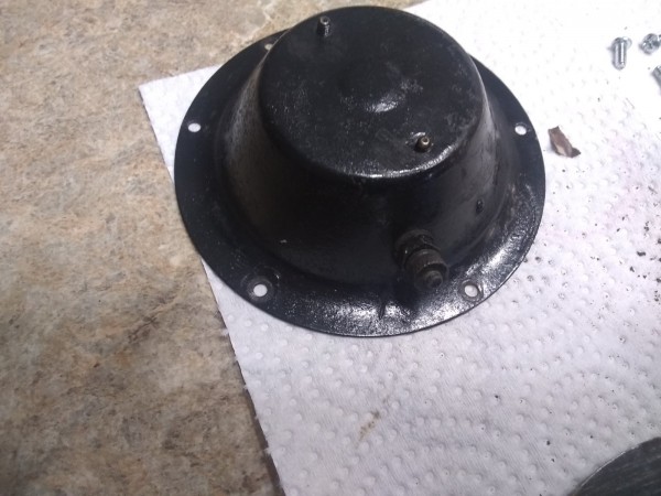

Re: Magneto Horn Repair
Post by TheSaintDiscJockey » Tue Mar 12, 2019 3:12 pm
Outside, one post.

Assemble it, hook it up to mag power, and try turning the adjusting screw to different positions. As Bob says, if there's continuity through the coil it should work.

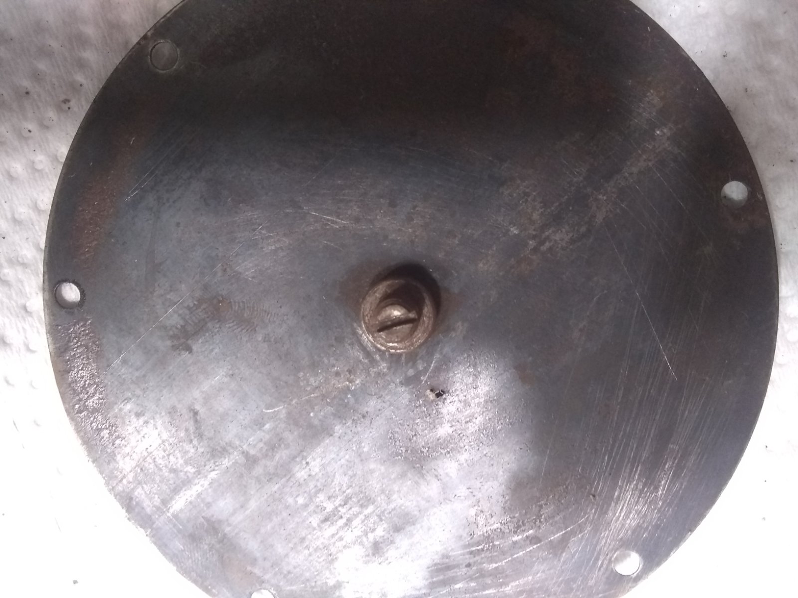

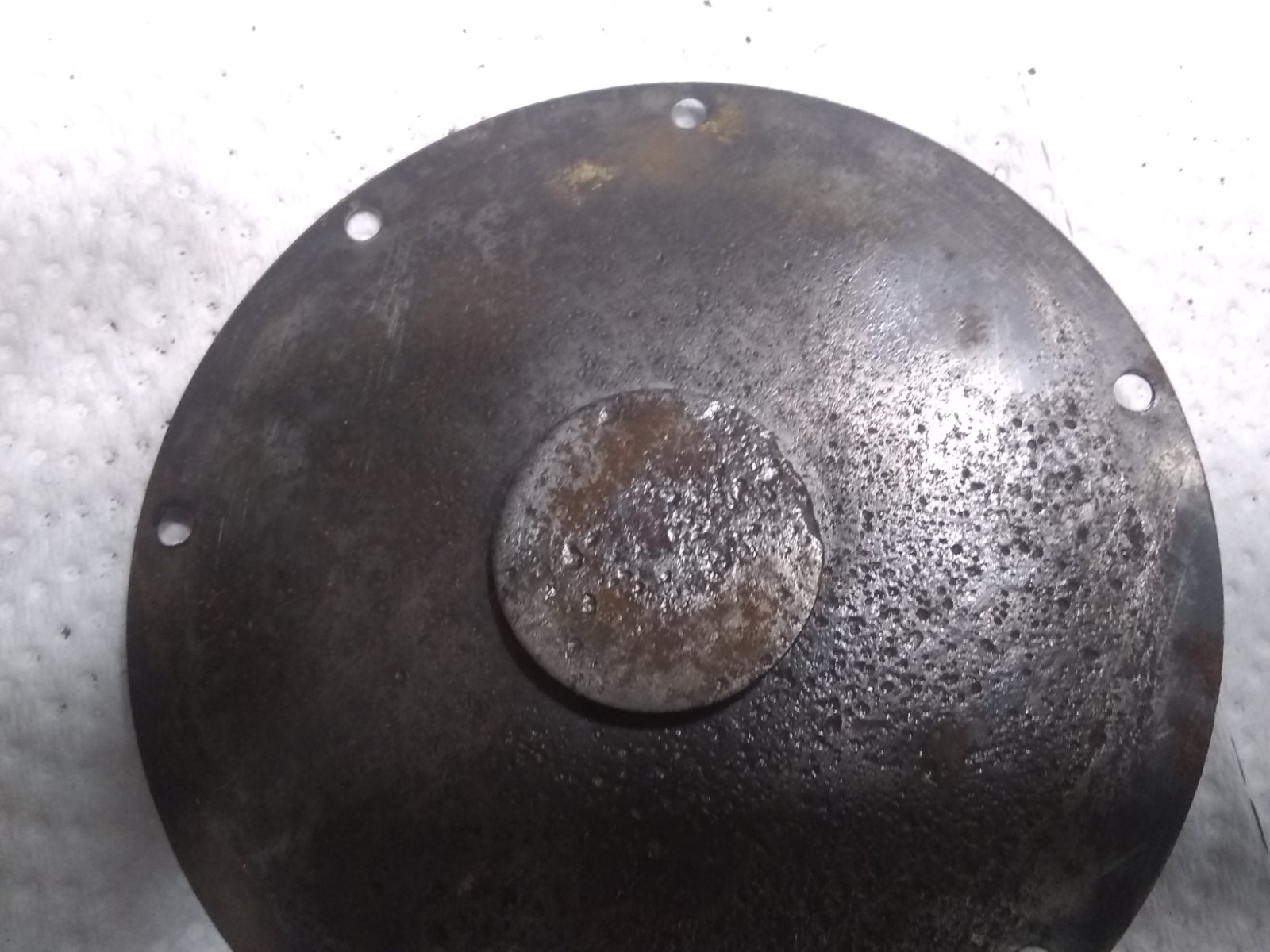

Brooks : The diaphragm needs space to move, and that's provided by two paper "gaskets", one on each side of the diaphragm. Make sure that the adjustment screw and locking nut are free before assembling it to make final adjustment easier (possible). Cheers : Bruce

Magneto horns need to be tested and adjusted with AC power, not DC. An old electric toy train transformer or door bell transformer works good.
