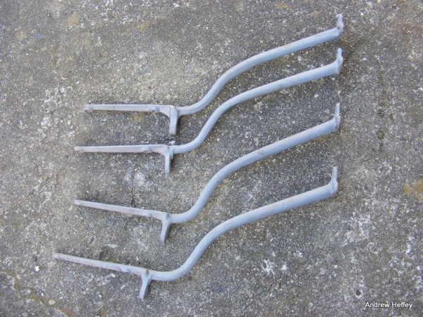

The bottom three brackets in Frank's pic look more "true to a '13", as the end with the mounting hole for 13's were a bit "thinner" than the earlier ones. His top one is more like for 1911-1912, just for info. As hard as they are to find sometimes, getting any like that will be a plus. The stamped brackets are a dime a dozen of course!

Frank has spotted a little recognised difference in these brackets. If you look closely at the top one, you will notice visible lines down the side of the bracket. These show that the bracket was forged on dies which stamped from top to bottom. The remaining three, and all those which came after, were stamped from the side, and the forge flashing runs along the top and bottom of the bracket.
The lug for the truss rod is also heavier on the early type, as is shown. Also, the underside of frame mounting on the early ones is concave whereas that on the later ones is convex. They are also different in cross section, the arms being more pear shaped on the early ones.
The question arises as to when the changes were made. 1913 may be a little early for the later, thinner type.

Allan the MTFCI judging guidelines show the thinner ends as starting in 1913. These brackets underwent many changes, some very subtle and hard to spot.
I went through this while restoring my '13 for judging with MTFCI.

According to Ford, the thickness of the truss rod loop was changed to a minimum of 3/8" and a maximum of 7/16" in a drawing dated 2-4-13. At the same time, the thickness of the runningboard support boss was 7/16". Before this, 1910-12, 7/16" was the minimum. Then on 2-25-16, the loop was changed to 5/16" and the RB boss to a minimum of 5/16" and a maximum of 3/8". These specs remained through the end of the forged support production in 1919.
