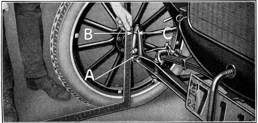

I'm not convinced that the service manual is accurate. It states:
"The front axle should have a 5-1/2° pitch toward rear of car. To check the pitch, place the
car on a floor having a level surface. A square is then positioned with one edge on the floor
and the other edge resting against lower spindle body bushing in front axle (See “A” Fig.
119)."
...and also:
"The distance between the square “B” and the upper spindle body bushing “C” should now
be measured. The distance between these points should measure not less than 1/4” or more
than 5/16”."
Either the 5 1/2° is wrong or the 1/4" to 5/16" is wrong. The spindle body without bushings is 4 1/2" surface-to-surface. With new bushings, my spindles are 4 3/4" from surface-to-surface. I calculated the angle using the mid points of the bushing dimensions (4 5/8") and horizontal distance (9/32"). The angle is 3 1/2°.
If I assume that the 5.5° is correct then the difference between upper and lower points is 7/16", not 9/32". That is calculated by multiplying 4-5/8" by the sine of 5.5°.

Mark. Keen observation. The service manual has an error. I also did the math years ago & found this discrepency.
When I got my 14, it had 5/8" rake. I noticed it steered stiffer than my other T's, but, was real stable @ top speeds. So I investigated & did the math. With this info, I set that rake to 1/2" for freeway stability.

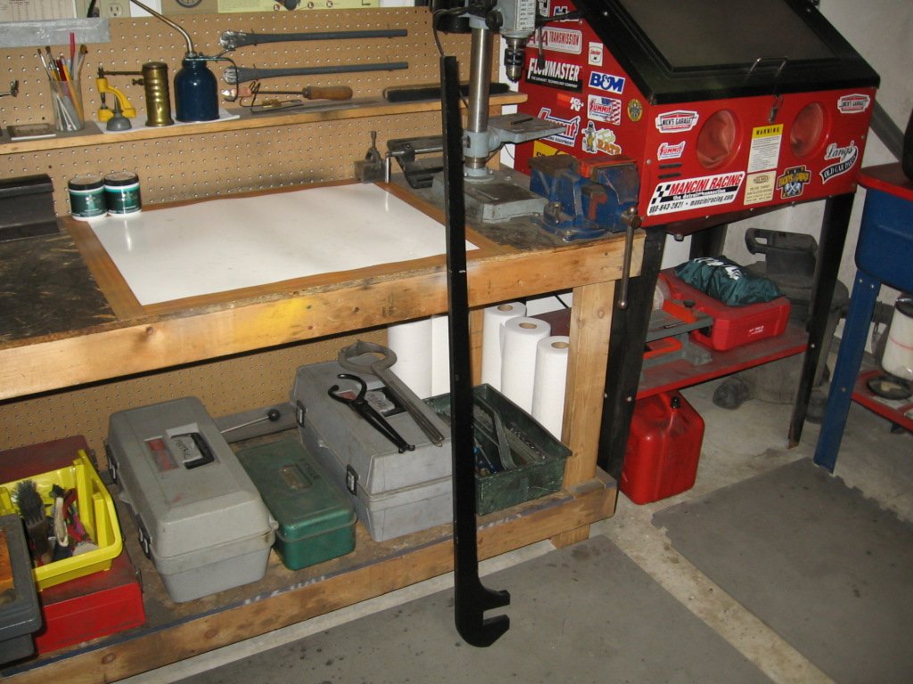

The prescribed adjustment is a 4' bending tool @ the axle outboard ends. A 3' pipe wrench + a cheater bar works also.

Yes, you end up bending the end of the wishbone. Here is a modern reproduction of the tool. I bought it on Ebay, I think. Might have been the forum classifieds, I don't remember. It is 4 feet tall and laser cut out of 3/4 inch steel.
Before you bend anything, verify that your spring perches are oriented correctly. If they are installed backwards, the axle will tilt forward rather than lean back, making the car unstable.

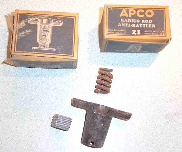

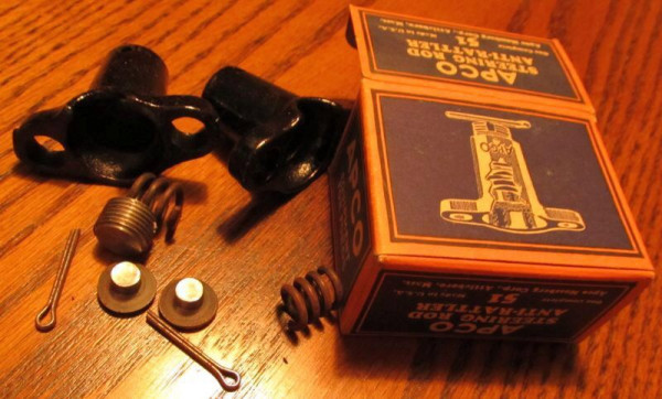

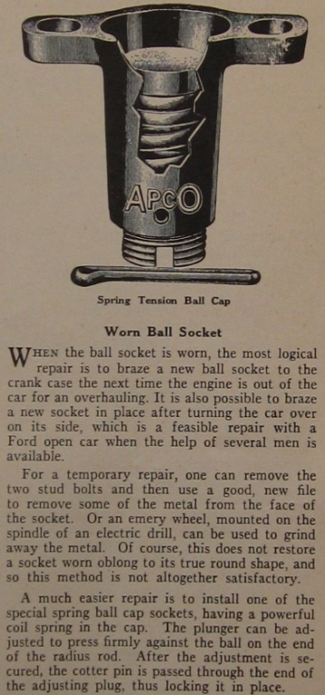

Adding a shim or leather may temporarily reduce wear slop, but, it will have no measurable effect on rake. 1/8" over a 3' length is near nothing.

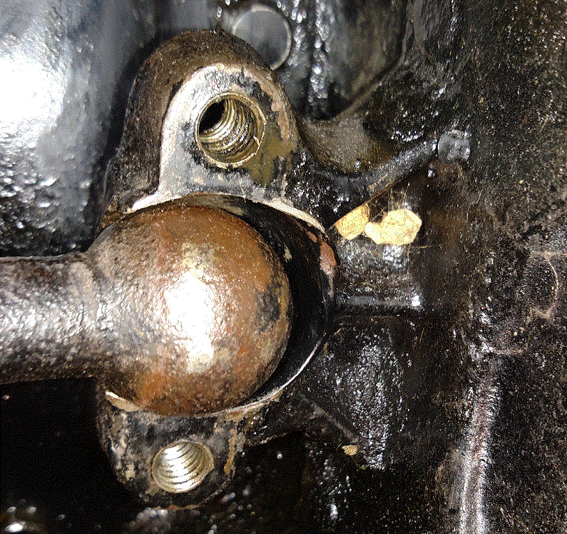

I have come up with a fix for a worn pan radius rod ball. The idea is to use a second radius rod cap as the base. Space it up from the original mount. 2 7/16 nf nuts work. Longer studs(.75-1" longer). Drill for safety wire add springs & nuts as original. This mod lowers the radius rod ball 5/8-3/4" If i did my math right, thats less than 1.4 degrees.
Posts: 8643
Re: Front end wandering
Post by TXGOAT2 » Thu May 20, 2021 2:42 pm
That's a better idea, and it would probably be enough to get you in the ball park. A spherical bushing machined out of Delrin, then split and hollowed out asymetrically to fit the ball would work well. It would need some kind of key or lug to prevent it from turning. Some Jeep people with late model Wranglers have had wander issues related to low caster, and getting to 6 or 7 degrees seems to work well in those cases.

John, I had to do something similar to fix my wishbone's socket.
I bought a wishbone cap and milled it to fit into the existing giant cavity and JB Welded it in place. It will have to do until I get a better engine pan. This method lowered the ball by less than 1/4". I made longer studs and I plan to reinstall my front axle this weekend.
There is another thing to consider. There are more than one length and angle of under-axle wishbones. There was a thread about that a year or so ago. I think it was in a thread where a member was repairing a wrecked front end.

Didnt know about different length wishbones. Must be 26-7 with the lower spring arch would be shorter.
I have seen where a worn mount is welded up & remachined with a ball end mill. The cost of that cutter turns me off. I do build up the wishbone ball with welding & grinding back to stock diameter.
No reason I can see your fix is not a permanent one. I wouldnt be in a hurry to find a "less worn" pan.
