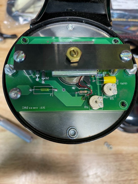

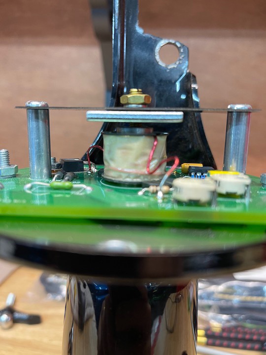

So I was able to take some pictures. I could only see writing on the circuitboard. I couldn't find anything on the body of the horn. I never knew that this may only be able to run on the Mag. That could be.
This is what the guts look like

That appears to be a "Fun Projects" reproduction horn with a '26 - '27 mount - maybe John will respond.

I agree with Steve, Based on the mount it looks like a 26/7 horn and judging from the base, where the circuit board is, its to large to be a mag horn. I believe that the adjustment may be the brass nut with the slotted bolt for a flat head screwdriver. Simply connect the horn and tighten or loosen the nut to increase or decrease the space between the contact or points, if you will, so the magnet will engage causing the rectangular spring metal plates will vibrate resulting in a sound. That’s if you’ve looked down the bell and didn’t see a flat blade screw or perhaps Philips head or it could even be a nut to tighten or loosen the diaphragm for a different pitch. I see pop rivets on the support plate. So it very well could be the brass nut and slotted bolt. Just another question is there one wire or bolt to connect the positive wire? If so how did you you ground it? If there are two wires or connectors did you hook both positive & negative up? Just using Ockham’s razor, "the simplest explanation is usually the best one.", to explain why it’s not working.

I have a 1926 battery horn and a magneto horn, neither installed at this point. The mounting bracket looks like 26-27. The wide cover looks like my battery horn. The magneto horn would have a narrower dome cover than this one. The large coil in the middle in highest probability is an electromagnet not a transformer. Transformers only work with A/C (magneto), not D/C. You can test the coil to see if there is an open, preventing it from operating. But if the ICs are burned out and you cannot get a replacement circuit, then consider getting mechanical components from a donor horn. Radio Shack in the 70s had electronic learning kits that taught you how to make an oscillator circuit, keeping the coil. I'm sure youtube can help if you feel like pursuing that endeavor.

That horn could be 6 or 12 v negative ground as both were made by Fun Projects. Bird haven now makes these and you could contact them for repair.
Reading the pdf Instructions on their page tells to not connect other than neg ground or damage will occur to the electronic driver, also the powder coated unit is grounded by the bracket, there must be hard contact with star washers to cut to clean metal, same with the cover, it won’t operate with the cover off.
