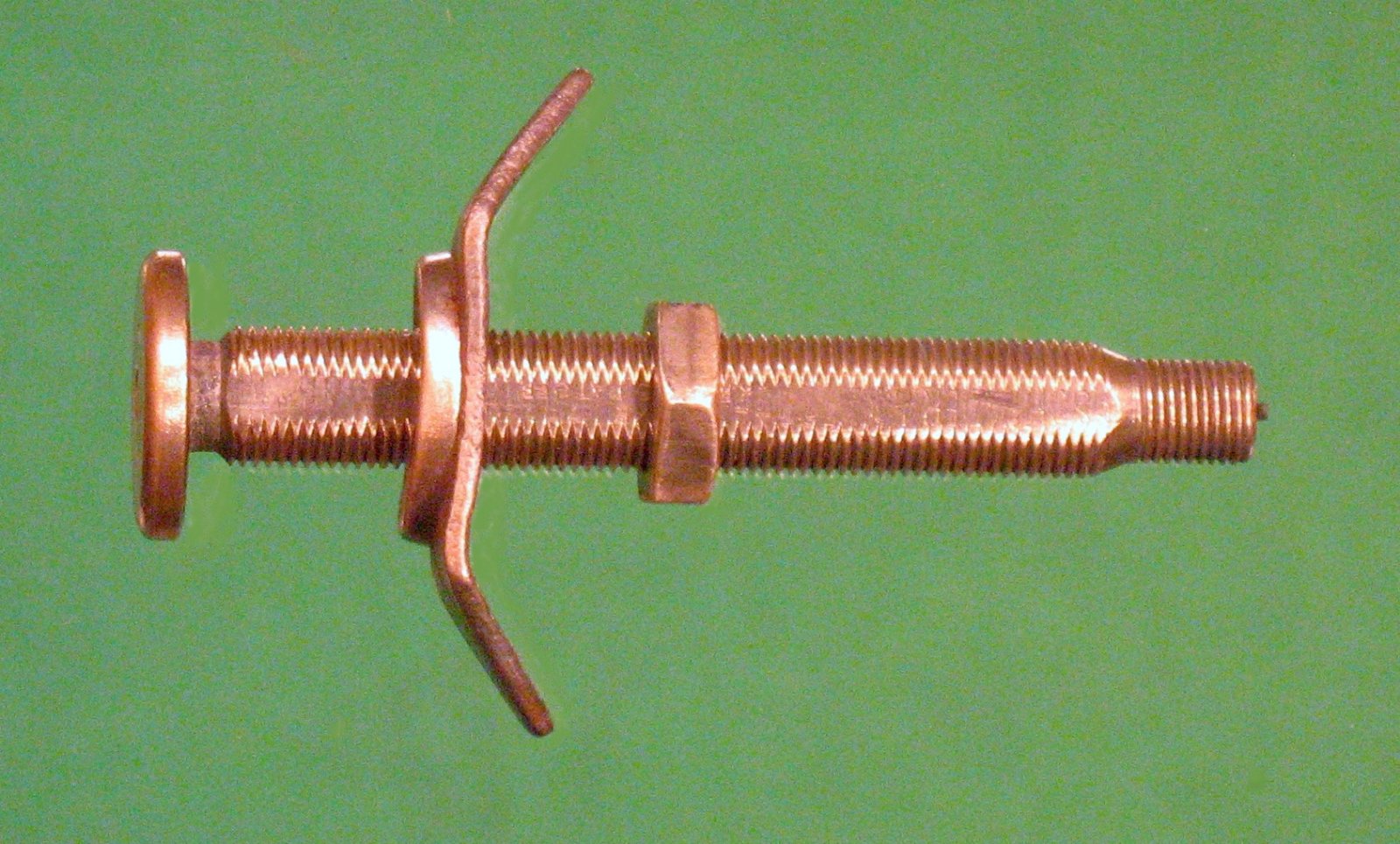

Post by Original Smith » Wed Mar 13, 2019 6:02 pm
If you use the one Steve posted, it may or may not be correct. It must be a Schrader 777 or 888 to work on a T. The ones supplied by the vendors are not correct, so there is no reason to waste you time. The best bet is to find originals, and install them yourself by removing the rubber stem. I've been doing this for years.

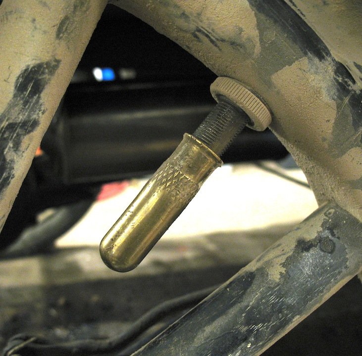

Posts: 7411
Re: Metal stemmed inner tubes
Post by Steve Jelf » Wed Mar 13, 2019 10:03 pm
I'll disagree partially with Larry. While 777 and 888 are correct, 724 and 725 will work on a T even though they're larger and not correct. How do I know? Because my 1915 is currently wearing them. Nobody will know unless they take the covers off. :)
