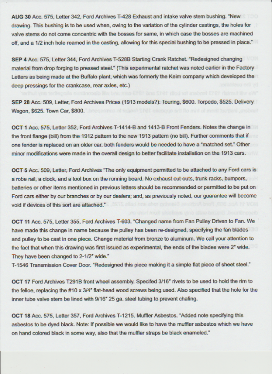

Robe rails however did sell in good numbers, and many original survivor cars have them still.

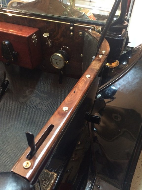

Some people ( like me) love accessories, Larry. Step plates can easily be installed without drilling a hole. Here are my ORIGINAL set of 4, installed without drilling and easily reversible. Just ask how, if interested.

By the way, before Larry has a heart attack , the tool box is also installed without drilling any holes! I could never personally drill a hole in an original car ( or station wagon)

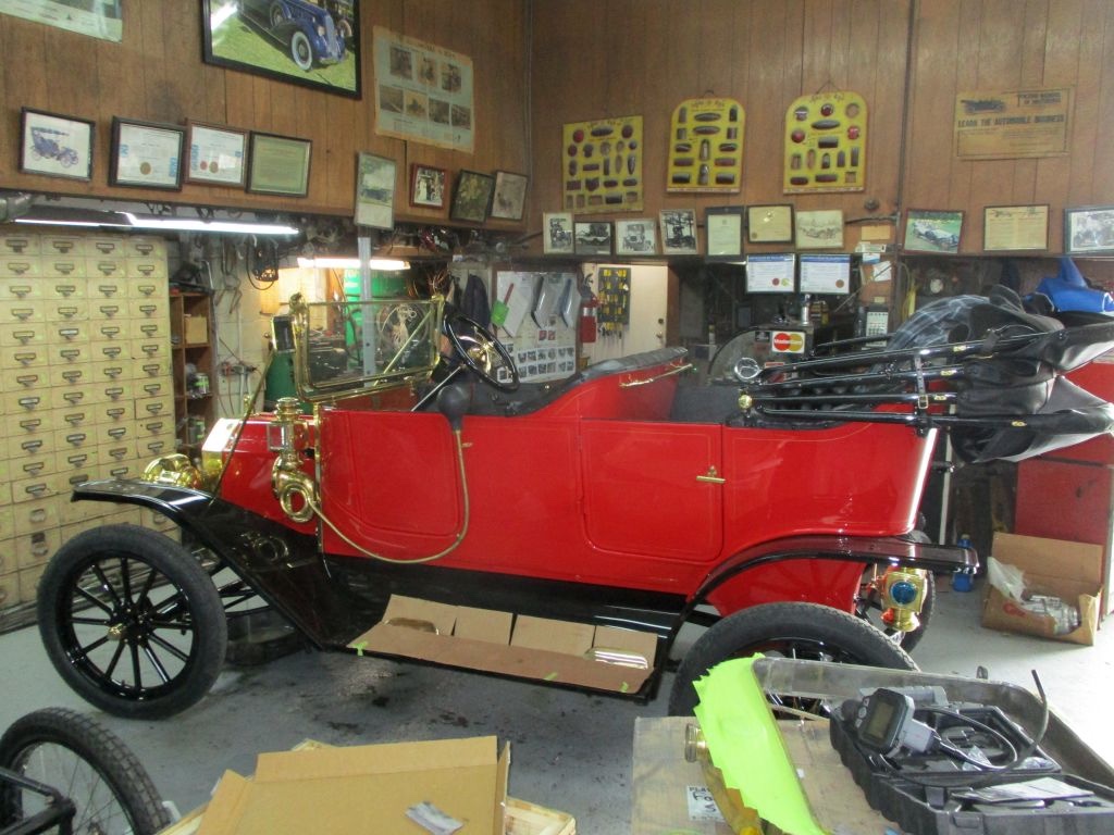

Add whatever your little heart desires!
We are only temporary care takers of Henry's beautiful creation.
Enjoy your car the way you want it!
This is my '12 during restoration and the robe rail is clearly visible. It's mounted to the specs below.

Although not exactly bling, when I bought my '13 Touring, one of the Garnish trim pieces was missing. The originals were pressed metal. A hundred years ago, owners could buy custom wood trim for a couple bucks. I went to my wood scrap box, re-sawed some pieces, and made some walnut burl garnish.

I have seen the wood trim and it looks very nice!!! Bud.

Be careful there is a letter from early 1913 which indicates only a clock, robe rail and running board tool box may be added any other added accessories will void your warranty. LOL

Oct 5 1912 I think there were a lot of void warranties

Well...I would not want to void my warrantee. One of the first things I want to do when I complete my restoration is to drive my 1914 to the local Ford dealership and ask them to look at some made up problem....and then tell them there is a 1915 service bulletin that says Ford will fix this problem anytime in the future.... I just want to see what they say.
As a thought, I wonder if there were any service bulletins from 1914-1915 that say "Ford will fix this issue" without giving an expiration date?
