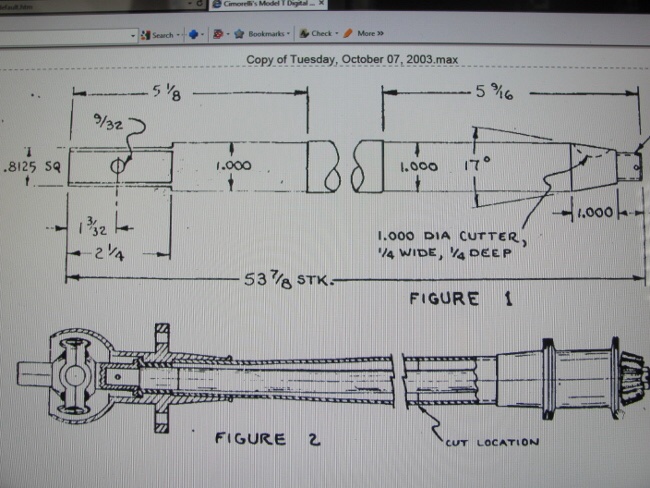

- Posts: 5503
Re: How do I measure and cut a driveshaft.
The cast iron uses a different length then the original aluminum 2 speed or KC Warford. You need to cut 15.75 off the stock driveshaft when installing the cast iron 3 speed or original aluminum 3 speed with the intermediate coupling. I cut mine and used above drawings to locate the hole for U-joint pin at that end.
http://www.mtfca.com/discus/messages/59 ... 1478206457

- Posts: 5503
And I even asked the question back in 2014; (re the 3 speed aluminum)
http://www.mtfca.com/discus/messages/41 ... 1418221819
I spent some time looking for how much to cut off for installing without the coupler, best I could find was 12+ inches.
I know that some weld up the input shaft on the 3 cast iron 3 speed and mill it to size to fit the tail shaft on the transmission.
