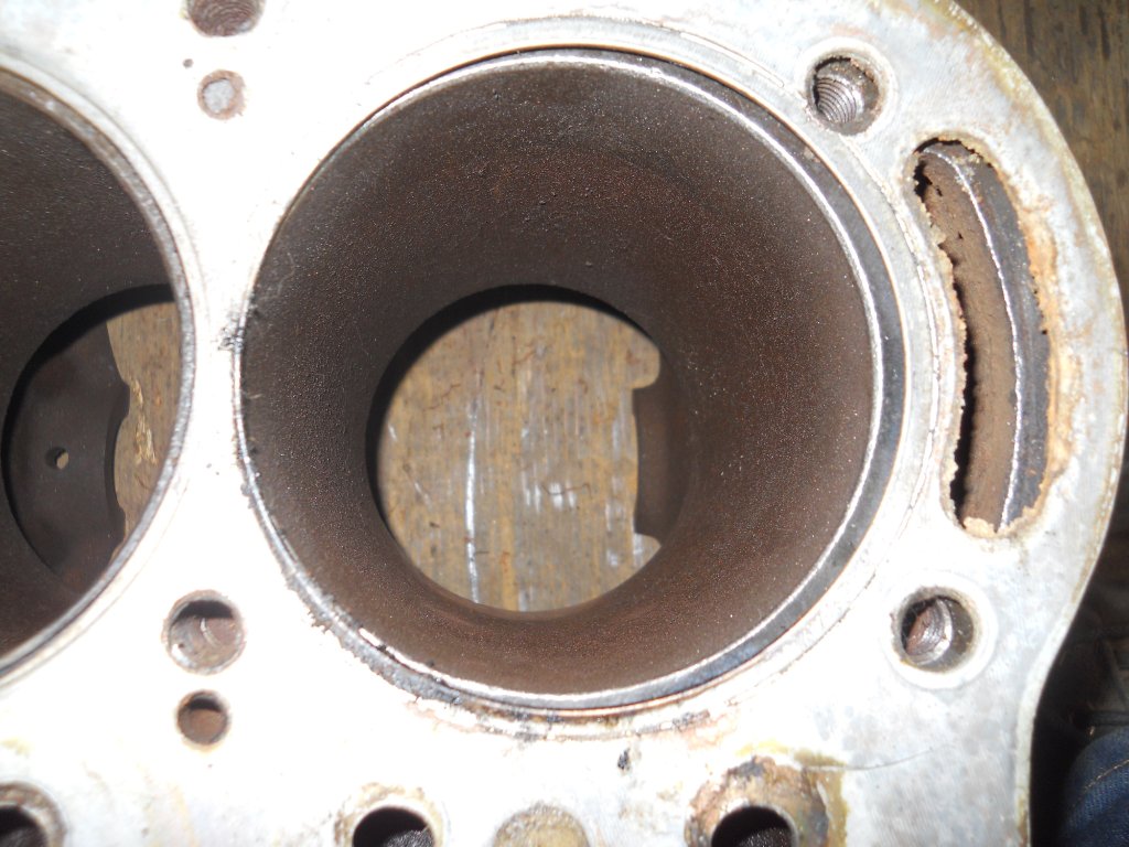

I have an unnumbered block that has some issues (one crack in valve chamber so far) that I was going to build a warmed up engine with. Last night I test fit my adapter plate (Chevrolet overhead) to see if all the bolt holes in it went deep enough for mounting bolts. Bores lined with the plate at 3&4, but No 1 was really off No2 somewhat. So today I placed the head gasket on with 2 bolts to set in place;

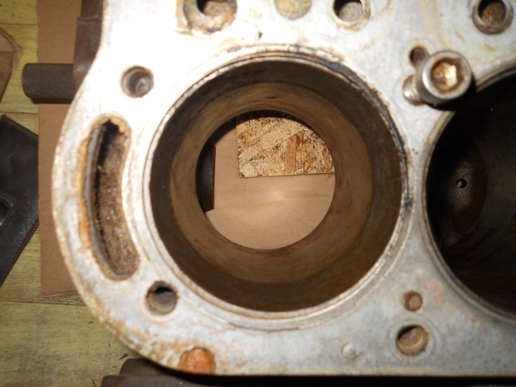

Then I placed the same gasket on another block;
Wondering now if there were more reasons the block may have been pulled out. Best I can tell it was put into service but does not look to have been run very long. Ether it's warped or something was miss drilled or bored. Need to do a bit more checking. In the first photo, the gasket is off the deck a little, but not enough to make a difference with the photo being shot from straight overhead.

If it’s off that much it would show up measuring from back to front using No.1 center to No. 4 center. An accurate machinist yard stick or a sheet metal yard stick should give you evenly spaced center to center measurements from No. 1 thru thru 4.
I’m not a machinist by no means but to me that would tell you if the bores are off.

RE evenly spaced, it is wider between 2 and 3 so not evenly spacing front to back. But good ideas on other checks.

If it's oversize, I'd guess someone bored it off-center to correct a wrist pin gouge or broken ring damage, or just by mistake. If that's the case, I don't think it's a good idea. You could probably get enough side clearance at the wrist pin for the piston to run, but I'd think you'd have a very thin cylinder on one side, and a high likelihood of head gasket issues.

Bolt holes look off, too... maybe it's an experimental block for Fordlandia...

Bore is still standard. Ok so I went out and flipped the gasket over, things line up. When I flip it back to correct orientation, still off some. With a T head gasket, it would not be noticeable because of the cutout for the valves. The overhead gasket has a full circle fire ring. Could be the gasket is off just a little. Bolt holes line up, so you are just seeing a shadow because the gasket is not sitting flat and camera was centered on the bore hole.

Have you tried other head gaskets? If you flip the gasket over and it fits, I would suspect the problem is the gasket.

It is the gasket. First try, it must have been cocked some how. On the first try, yes I did have it laying flat just somehow got wonky. Just went out and tried again, it fits good. Don't know what was going on so will need to watch it when I do the build up. (some day
